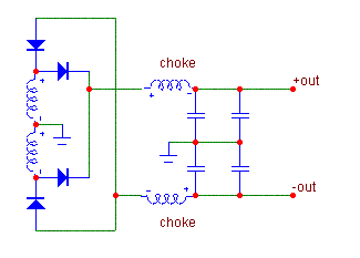

You should use output inductors (chokes). Don't worry too much about polarity on the chokes now. Also configure the rectification differently than you show. You may also have to add windings to the secondary after doing so to the primary. All the suggestions offered have been good. I would not even have seen the problem with your rectification if it had not been pointed out and I am surprised that I didn't think of the output chokes.
Something else may help you. I wind my chokes air core. I take magnet wire and wrap it around a smooth, round stick form in two sections separated by a short length of magnet wire. Then I bend the connecting wire to make the two halves next to each other so that they will pass current in opposite directions. This method should cancel EMI at a distance.
Try different sized chokes after the rectifiers until you get best performance. I usually make them just large enough to increase the efficiency to over 95%. But you will not reach that kind of efficiency with your circuit.
Correction
It occurred to me that the bridge rectifier in the schematic MaXiZ posted is the same as the discrete component set-up I posted. :bigeyes: Now I am thinking the problem is likely to have something to do with the transformer windings. I suggest you rewind your transformer, removing all the present turns and starting over. Make sure that you add more turns at least to the primary side than you had before. Try adding about 25% more turns and try it out. If the mosfets still overheat, try adding another 25% and do that up to 4 times, if needed, and let us know the results
