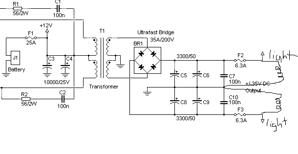

I've to rebuild...
I've to rebuild the sg3524 part..
Now following this schematic as shown on datasheet of 3524...
now i'll rewind the transfromer...
I hope now all will run perfectly...

I've winded the transformer and now all seems to run correctly except for this..
If i connect the bridge correctly i've no output instead if i connect only half bridge (negative side) all run correctly...
I'm confused...
Why?
I'm confused...
Why?
What's??? I build the schematic but i don't know the part name! Sorry!Check your feedback circuit.
???????????????????????????our zener diode/diodes in the circuit in series with the diode of the optocoupler are in some way problematic.
Ok, try these things instead, on second thought. Make sure your ultrafast bridge is in the circuit correctly. Also check C5 and C8, and C6 and C9 to see if you can tell that any of them are getting hot to the touch. One of them could be in backwards or could be shorting out because of an internal defect.
What's maybe wrong?
Aseems that it will continue go up on positive side...
And the capacitors is rated at 63V may explode?
You are correct about what can happen if you let the voltage keep rising without disconnecting power. Do you have positive and negative voltage now? You should always have some load connected to the output. I often use 120vac light bulbs for testing purposes. You will need one for each polarity output.
Yes as u can see... +63/-60! Finnally.. i were thinking that i'll never get that result!Do you have positive and negative voltage now?

120vac?? But i've dc not ac... anyway how should i connect them?I often use 120vac light bulbs for testing purposes
+/-?? +/0??
Do u mean this??
If so can i say my SMPS is ok an fully ok?
