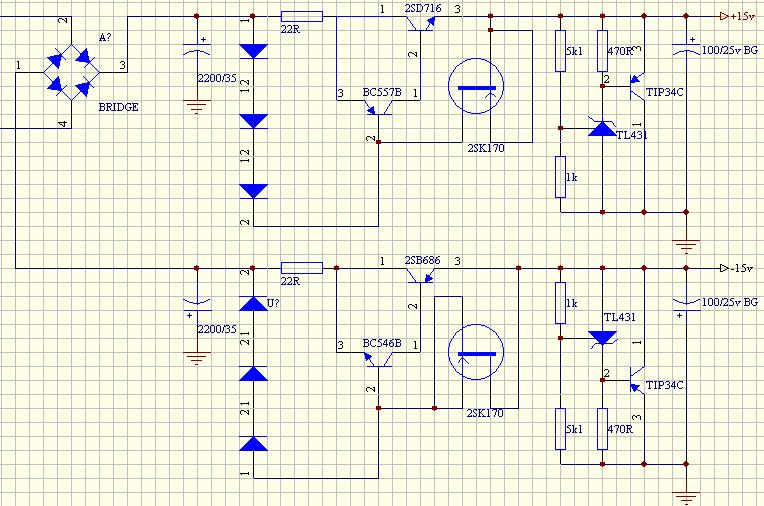

Shunt regulator for a phono pre
Having lived for a while with a gainclone i decided (maybe naively) that a full solid state system will be cool. Not that i don't like the sound of my valve phono and DHT (PX25) power amp, it's just that the success of the GC gave me hope that a simple but good sounding system is possible with premium quality opamps. So far the results have been encouraging, rather than exilarating, but of course i've always known that a good phono stage is a lot more difficult than a a good power amp.
I started the prototype with the intention to build several different power supply regulators and compare the sonics. Initially it was built with the 'standard' 317/337 combo and the sound was admittedly not too bad, but the usual 'greyness' and 'thickness' of the regulators was unmistakeable. My first 'improvement' was a simple tl431 based shunt fed from a ballast resistor. The midrange cleaned up remarkably but in general the sound became less balanced, with very weak bass. Next the resistor was replaced with a 317 hooked as a current source at 70mA. Each rail of the phono draws around 50mA, so i thought 20mA for the shunt transistor should be enough. The bass came back, but interestingly a lot of the 'greyness' i've learnt to associate with the 317 came back as well. So, maybe a 317 is not a perfect CS after all 🙂.
Finally i built the simple CS shown on the diagram: it's based upon a forward diode drop. As anticipated the sound was now really better. If anything, the bass was maybe a tad too soft compared to the 317/337 regulators but everything else more than made up for it. As you can see i use very substantial transistors for both the current source and the shunt element. Initially tried BD139/BD140 but they really didn't sound as good.
So, happy as i am with the result, there is certainly room for improvement. I'll appreciate all comments and suggestions and some time next week will try to compare this to a Jung type regulator.

You are some way ahead of me in your phono amp regulator study.
I had thought of trying the Jung super-reg, probably using ALW's circuit+boards, and then following that with a shunt regulator to see what difference it makes. Interestingly, ALW uses the 317/337 as a pre-regulator for the super-reg, so I am guessing that the "greyness" you hear is cleaned up by the super-reg.
You might clean up your own current source by using a LED or buried-channel zener for the voltage reference at the input.

I started this journey 'backwards' with the simple shunt-reg as i wanted something small, cheap and not prone to oscillations and problems. Mostly because i intend having a set of the regs next to each op-amp/buffer. The Jung solution is not so well suited to the idea of having 2 or 3 per channel. Also i have serious doubts about the preregulators. Having never built a Jung/ALW reg i still have some experience with what Audio Research used to use when the SP10 was the best preamp ever. It is similar to Jung in using an opamp with a series-pass transistor, but it's output is floating and not referenced to a particular voltage, just used to buffer each stage and fed from a preregulator. I never got to like what it did to the sound.
Interestingly Elso Kwak seems to also dislike preregulators, i'll certainy try them, but against clear prejudice.

Hi Rob
After reading your post i was annoyed for not having thought of this myself 🙂 A .47 seems a bit low for a 5k1 resistor so i tried a 3.3uF Wima MKP (admittedly not my favourite). To my surpise the sound did not get any better; to the contrary - it lost dynamics. Weird?

An interesting and thoughtful post Andy. I used tl431 primarily for the low noise and simplicity. If low noise is not a priority i'll gladly get rid of it although most of the discrete circuits i've seen typically consist of differential amp with/without cs/c mirrors, current amp,shunt element - easily 7-8 transistors per rail, not counting the CCS. Not ideal if you want 4 of these.

I use a TL431 to control the source of a grounded gate mosfet shunt regulator. This enables 340V B+ regulation to within about 0.1V. I do not believe noise is the issue either; more the output characteristics of the regulator, particularly where tubes are used. The so-called 'tube' sound is in fact largely the interaction with the power supply (H2 generation); you don't want a rigidly regulated power supply, rather you want a fixed, ohmic source. Like you, I don't use a cap to bypass the upper divider. Causes overcorrection; just not necessary.

As an example, take the Jung circuit and remove the gain bypass cap, increasing the noise gain of the circuit. This, in my 24V supplies increases noise, output impedance and worsens line rejection by 11dB!
It also sounds a LOT better 🙂

Hmmm, interesting! Makes me wonder if the improvement in sound was due to having improved the stability of the regulator due to the reduction in loop gain.

Folks, forgive me if I have overlooked something on this thread. However, this is my take on 317,337 IC regulators: BE CAREFUL! Don't put a really good cap directly at the output of one. It will cause noise ringing. There was a good article on this in 'EDN' or 'ED' some years ago. What happens is this: The regulator starts increasing its output impedance, because it has a finite bandwidth and must roll off its gain early. This RISE in output impedance looks just like a synthetic inductor at the output. Put a really good cap directly at the output, and it RINGS! This is because there is no series damping. Add a 2 ohm resistor in series with the really good cap, and you are probably OK. However, why then would we put a really good cap at the output, if we have to add a 2 ohm resistor to spoil the Q? This can make things really interesting, and confusing, if you don't have any idea of what is going on.
Yep, pretty much what I was getting at (without beign so specific) in post #6.
The comment John makes though applies to any feedback regulator, with the possible exception of some of the newer fast transient performance devices, which are optimised for low ESR caps.
I have no idea how these devices sound though.
As I mentioned almost all of the audio grade caps (elna, nich) have a very nice impedance curve for this application, being resisitive above the min Z point of their curve, this then masks the effect of ESL, until the ESL has greater impedance than the ESR element.
Adding a series R is what I currently do, but I use a lower value of 0.5R at present (with a PPS film cap, which sounds, in my specific application, way better that a 'lytic).
I am about to measure / listen to various R's here, I must admit gut feel tells me 2 ohms is a lot - the worst 'lytics only approach 500mOhm ESR, but Mr Curl is an experienced guy, so I'd never ignore free guidance from such sources 😉
This is a classic example of where SPICE modelling can trip you up - if you don't model parasitics and non-ideal components the results will not bear any resemblance whatsoever to the real world results.
BTW, I have that app note John mentions somewhere, it was an EDN article by a National Semi engineer - I'll see if I can dig it out and stick it up for download.
The basics are as John says, the o/p of the reg appears inductive by an amount that varies with load, amongst other things.
A low ESR cap produces a high-Q noise peak at the reg o/p, a low ESR one produces a smaller amplitude peak, with greater occupied bandwidth as the resonant frequency / Q would predict.
I found that I could derive output L of the reg (1 / (2.pi.Sqrt(L.C)), then change the C and predict the noise peak frequency with high accuracy, for a fixed load on an LM317 or similar.
