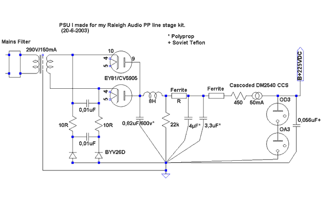

Now I am still im my infancy with regard to tubes. So I apologize to anyone offended by my stupid questions here.
I found a 0D3 regulator tube or so I am told. I was wondering if I can use it in a preamp that I plan to use. I need about 144-150 or so volts on the plate of a 5687 tube for this project. My power supply is going to be a 300-0-300 transformer followed by a 30H 40ma choke, a 50mfd/500 cap, a 30H choke, and a 50mfd cap. I'm going to guess that I will be somewhere around 220 volts B+ here. I will need to drop off the excess voltage so I will need to figure a resistor. The tube I am assuming will draw about 12MA. per section?
Now, can I use the 0D3 in place of the voltage dropping resistor to end up with my 150volts? I am told it will give 150volts out. If so how do I wire it up? Or am I trying to do something very stupid here?
Frank? anyone?

The OD3 is a mercury vapor cold cathode voltage regulator suitable for 150VDC at 40mA max.
It needs a striking voltage ( igniting it) of 185V min. so, yes this should work.
You'll need to calculate a dropper resistor to arrive at the "striking" voltage ( a little higher won't hurt but too low and the tube won't light up) using Ohms' law.
It is also recommended to decouple the tube using a 0.100uF filmcap (max) to prevent the tube from oscillating.
Just like a zener it will try to clamp the output at 150V.

IIRC, theres two pins that are joined in the 0D3, so that if the tube is missing from the socket, you can use it as a fuse, kind of..
0D3 is 40mA max, 150v ±5v regulation.
it needs at least 5ma flowing through it though, to stay lit.
so, say you have 300v b+, you need a resistor from B+ to the anode of the 0D3 for 150v 40ma =3,75K.
now, at the anode of the 0D3 you can pull 0...35ma, and it will stay regulated at 150±5v. if you pull more than 35mA the 0D3 will extinguish though (it will no longer have at least 5mA flowing through it) and you will lose regulation.

You're all wrong.
take the total load and add half the VR tube's current max to it. So, if we are regulating a stage with a 12AU7 in it, we add 20mA plus 10mA... 30mA total current. Then we take the total voltage BEFORE the VR tube stage. Let's say 200v. So, we need to regulate 50v, at 30mA load... this means we need a resistor of 1660 ohms, 2 watts.
I just built an amp with all VR tubes in the PSU. Trust me.
Looks to me like Joel is right here.
I have built and worked on many circuits with regulator tubes in them, I've grown to like the OD3 a lot. I also design many of my circuits with OD3's since I have a whole box of them.

Joel said:You're all wrong.
Well, I could go into excruciating detail but I'm too damn tired so pffbt. 🙁
Tim
Looks good Bas, although it's more of a series type regulator circuit isn't it, due to the CCS rather than solely a shunt?
Joel
If I understand you correctly you are figuring half the current of the 0D3 and that is 20ma, and adding 10ma which is the current draw of one section of a 12AU7. This yealds a total of 30ma. With a given B+ of 200 volts we need to drop 50 volts so we need a resistor before the 0D3 of 1.666 @ 1.5 watts or probably better to double the wattage rating to be safe.
So if I were to use 2 sections of a 5687 that are roughly 12ma ea and a supply voltage of say 225 volts I would figure a load of half the VR
plus 24ma or 44ma dropping 75volts, a resistor of 1.7k at 3.3 watts.

You are exactly correct up until that last paragraph which I don't quite understand. You can use the VR tube with any load you like - there is no "maxing it out", provided you put enough resistance in front of it to drop the excess voltage.
The reason we choose a value of half the VR tube's max current is so that it is allowed to swing up and down without maxing out or cutting off as the current demand in the amp goes up and down - in other words, we are putting it in the middle of its curve.
Things to keep in mind though are that the best regulation will occur when you have a very low current demand with a very large dropping resistor in front of the VR tube. Why? Well, think of it as having a much greater "impact" on the voltage drop with only a small change in the VR tube's current. If you have a very small dropping resistor, the VR tube has to work very hard (big current swing) in order to drop the same amount of voltage.
