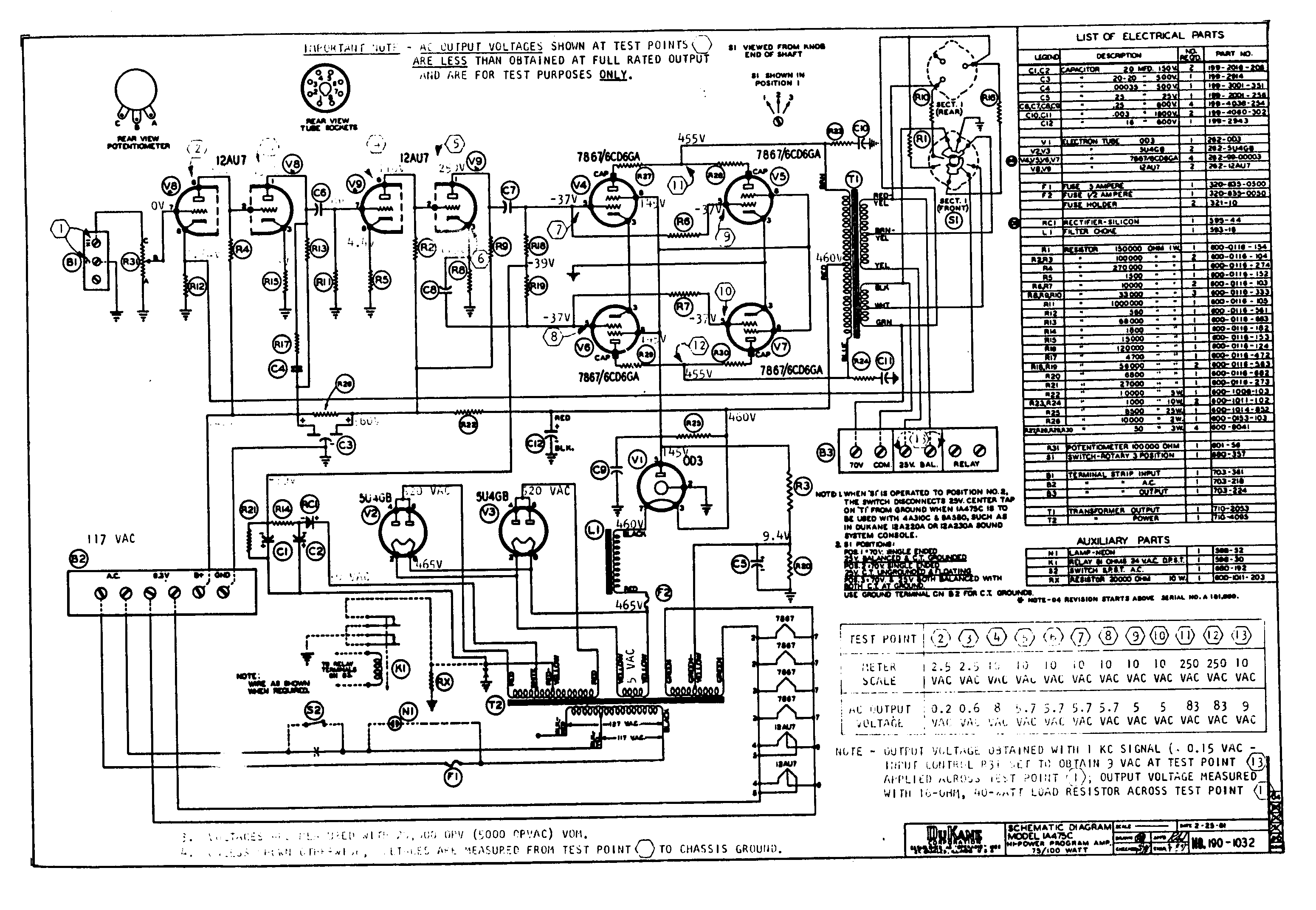

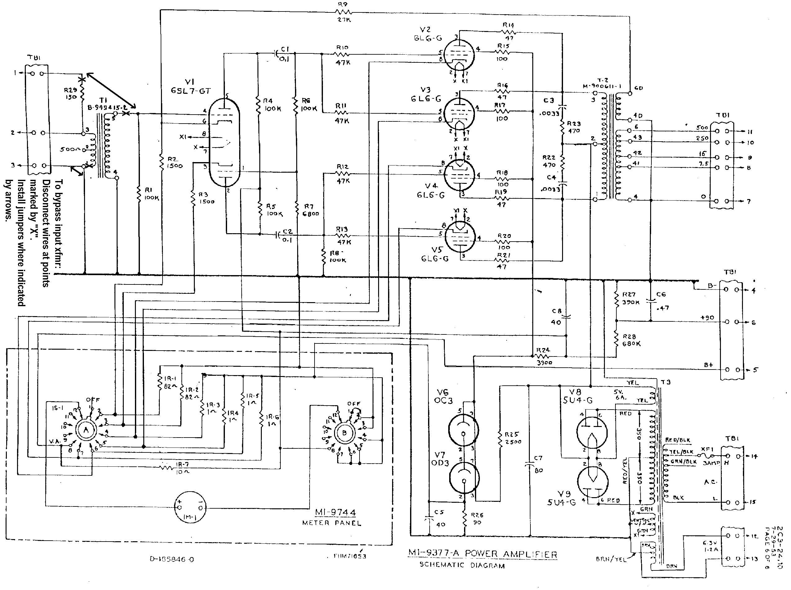

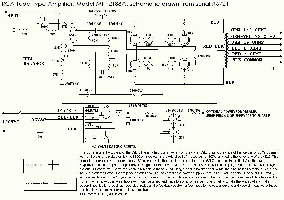

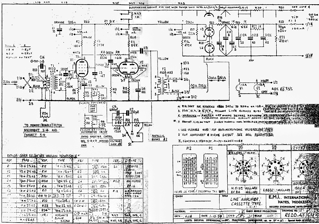

Attached are some examples of mostly profesional equipment with the 0D3 (or the 0A2 in the microphone amplifers of the EMI REDD.47 mixing console) as shunt voltage regulators. In some of them they are used to feed screen grids of power tubes. And there are many more examples (see post #118 for an example with 2 x ZZ1040).
Addition: Here you can find more equipment in which the 0D3 is being used: 0D3, Tube 0D3; Rohre 0D3 ID4081, Voltage Regulator, single
2 x 12AU7 dc-coupled + 4 x 7867 pp + 2 x 5U4GB + 0D3 (Dukane 1A475C).gif195.7 KB · Views: 197

Transformer-coupled 6SL7 + 4 x 6L6G pp + 2 x 5U4G + 0C3 + 0D3 (RCA MI-9377).gif99.2 KB · Views: 191
Transformer-coupled EF86 + ECC88 para parafeed opt + 2 x 0A2 (REDD.47).gif287.9 KB · Views: 191
