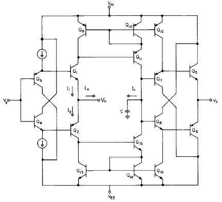

I got inspired to make one amp (headphone for starters) with a classic current feedback topology like in integrated ones. Just for fun and for pure technical reasons only.
Right now I'm just interested in the theory (mirrored over to real thing amp), don't care how good it sounds.

If you plan to make one from scratch for the learning experience......good idea, BTW, then you should consider either using things like MAT-04 or the like.....or put some degeneration resisitors in the emitter legs of the current mirrors. Other wise, thermal effects will cause it to go nuts.
The inverting configuration is easier to work with.

My plan was to use regular BC5xx or BC8xx together with degeneration resistors, max 100 ohms or so.
I have read so much that I realize the high impedance node at the current mirror output is critical.
Resistor values sound ok. Suggested bias level also ok. Problem is stray capacitance at the nodes. Keep the resistor values for the feedback network low. (I assumne that you know this already, but just in case it slipped your memeory.....it happens to those of us who really don't understand what we are doing.)

Hello Per-Anders,
Classic Hiraga 20W amp has 600-650uA in the first (Q3, Q4) and a bit more than 1mA in the second part (Q1, Q2) of the diamond transistor. However it is entirely biased by resistors.
Btw, opamps (LM6171) that Meier uses are not CFAs. But approach is interesting anyway.

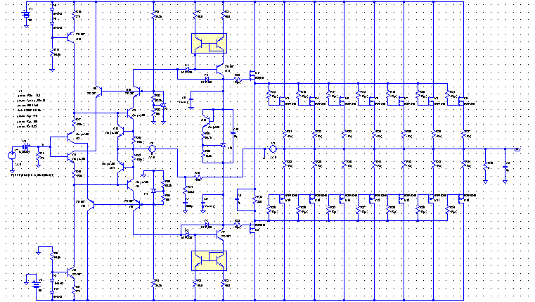

Hi Per-Anders,
Well, I realized that my power amp design was overkill for your application. It is designed around +/- 90 V rails, so it has the complications of cascoding for high voltage and high current output stage with many devices (a Holton rip-off). I've attached a schematic from LTSpice below.
Regarding slew rate, since the current for charging the compensation caps originates in the output stage, the slew rate should be nearly independent of the input stage bias current. You can see input stage current limiting in the schematic below. This stage could otherwise be blown out during slew rate testing, or clipping with low-frequency signals when the Baker clamp kicks in. It sounds like you're quite familiar with noise considerations, so there's nothing new in that regard.
At one time, I had thought of using the HA-5002 for the complementary buffers of a design similar to what you posted. It has separate plus and minus supplies for the two stages of emitter followers (four supply pins total), so you can pick off the exact point you need to hook up the current mirror. But it looks like the output stage runs at about 4-5 mA, a bit high, and the bandwidth is a bit higher than I'm comfortable with. It does put out 200mA, which is pretty cool. And it runs class A, which is a plus. I had even thought of using it as the input stage for my power amp. That high bias current scares me off though
As far as parts, I suspect that what's easy to obtain in your country may be difficult to obtain in mine, and vice versa. Judging by your site, you're a way more advanced builder than I am, so any practical information is something I'd be better off getting from you rather than the other way around. The last DIY project I did was a Leach amp... in 1979! At the places I worked before switching over to software, technicians did all the construction. But I'm getting back in the swing of things, thanks to this site and the people who post here.
I got confused by this. I had to check the datasheet. The LM6171 is infact a CFA inside but disguised as a normal opamp and this is accomplished by adding a buffer to the inverting input.Pedja said:Btw, opamps (LM6171) that Meier uses are not CFAs. But approach is interesting anyway.
You don't know me! Overkill is my trademarkandy_c said:Hi Per-Anders,
Anyway, nice design but it never left the computer?

I ended up abandoning that design. I was trying to produce a square wave at full output into a 2 uF load with no ringing or overshoot, using no output inductor. To get good stability with this load, I had to reduce the unity loop gain frequency quite a bit. Then there was not much feedback left at 20 kHz. A Fourier analysis using transient and sine wave input with SPICE showed the third harmonic at a disappointing 1 percent at 20 kHz, full power. This was not in the output stage, but somewhere in the input stage or current mirror (hard to separate with CFAs). I couldn't improve it. 1 percent is too much for a solid state amp! I ended up switching to a voltage feedback design, using some of the Douglas Self techniques to reduce the amp's open-loop distortion, but still keeping the global feedback low. I am still modifying the design, but so far I've gotten a 20x improvement in the computed third harmonic of 20 kHz, and the simulated square wave respoinse into 2 uF looks clean.

Okay. I found a simulation I've done of exactly the topology you posted. Maybe I'll send you that one? The power amp I posted contains devices that aren't in the standard LTSpice installation, so you'd have to install these first. But the simpler simulation uses only standard devices, so that's better I think.
