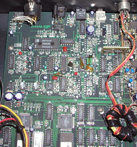

Thank you, Peter! The receiver is SAA7274 and digital filter is SAA7350. Is it correct? I noticed two (!) Motorola processors.
Comparing to ML360S, the sound is more listenable and involving, more musical as some may say. It has a bit less refinement, but overall I would prefer Bidat.
My unit isn't modified, although it has Supermod done. That DAC certainly needs modifications to achieve full potential..
dimitri said:Thank you, Peter! The receiver is SAA7274 and digital filter is SAA7350. Is it correct? I noticed two (!) Motorola processors.
Yes, that is correct. Email me for higher res pics.
The two DSP56002 form the digital filter and the SAA7350/TDA1547 combination make up the Bitstream dac. The SAA7350 is capable of operating as a dac on its own.

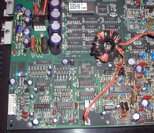

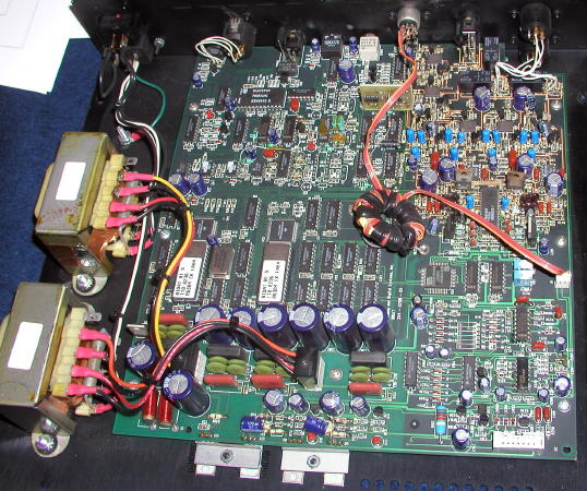

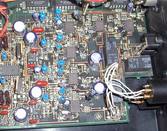

Peter Daniel said:Here are some pics of the Bidat
Wow. That appears to be an early BiDat.
Mine has a switching PS labeled EMM Labs. And overall the interior of mine looks more profesionally finished.
It seems the complexity of the BiDAT is kinda' the polar opposite of your DAC, Peter.
-Rob
From what I've read, switching PS is not really recommended for that DAC. Is the layout of your board different?
Peter Daniel said:From what I've read, switching PS is not really recommended for that DAC. Is the layout of your board different?

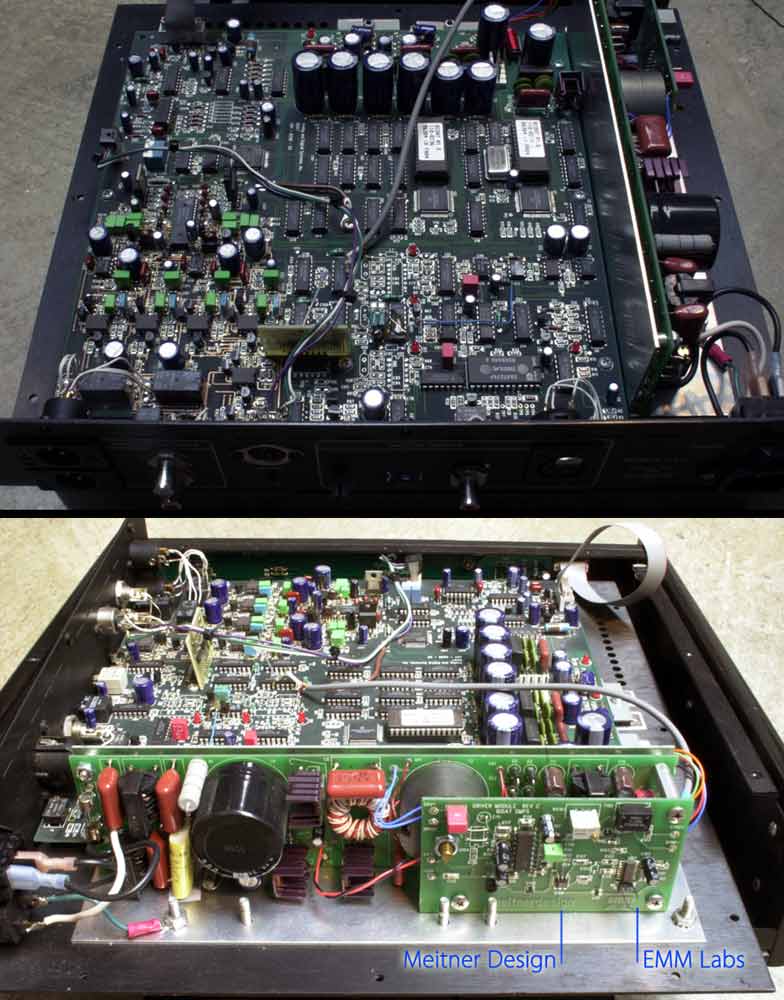

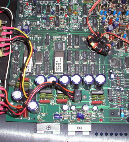

Shot some pics of the guts of my BiDAT. EEPROMS say Rev. 1.5b.
Thanks for the pics. Aside from SMPS PS (and some small caps) everything else looks the same. My software ver. is R1.5.
