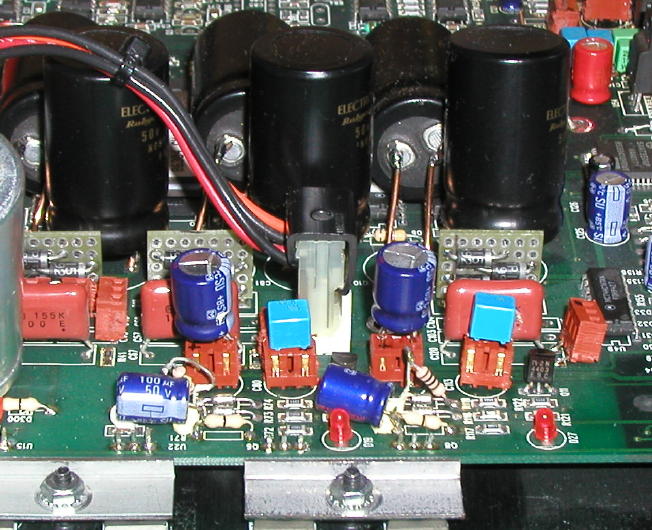

Peter Daniel said:After 2 days of listening, I'm pretty much tempted to remove the caps across the diodes in digital supplies as well.
ERO1830 0.01uF seemed to work best, but even those introduced certain veiling which seems too much of a trade off for smoothness. With the caps, the sound is loosing its "freshness", when they are removed, it's like the last curtain is lifted and gains in dimentionality are well perceived. The instruments suddenly have their own space, the sounds are _really_ 3-dimentional with layers of plans much better defined.
I started voicing the circuit without those caps in a first place, it may be different if someone does it with the caps across the diodes. It is possible that removing them then, has no advantage at all.

I worked today with the caps in analog regulators section. The two smaller caps on the right (originally 220/25V) are input bypas caps. I initially tried BG N 10uF but the sound thickened and lacked air and resolution. I installed ERO 10nF and this worked fine. Any cap here is in parallel with main filter caps, and since I'm using there BG N 1000/50, nothing really worked well in parallel, always adding coloration; the 10nF was still better than no cap at all.
The two bigger caps on the left, originally 470/16, were quite problematic to choose. I tried here almost everything I had available (BG N, BG FK, Nichicon FG, Elna Cerafine etc) but nothing sounded right, it was always forward, colored with tension that was hard to accept.
In the end, I installed back the original caps that were here(Panasonic SU) and suddenly everything locked in place and I got the smoothenss and relaxation I remebered so well and valued in the sound of that DAC. The certain organic quality came back and I knew that those two caps need to stay
There are still two more caps I didn't test, but after pleasant experience I had with old caps, I'm not sure I would touch those.
I also tried to remove the snubber network on transformer's secondaries (for now, in analog section only) and definitely prefered the sound without snubbers (1.5uF in series with 100R). The snubber was adding coloration without any perceived sonic advantage.
