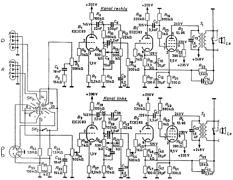

Schematic can be found here (i tried to attach it but it is too big) http://pjeantaud.free.fr/schemas/ag9016.zip (i hope he does not mind)

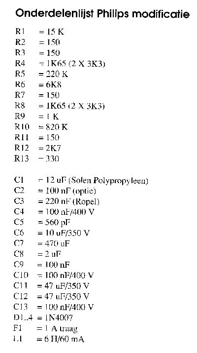

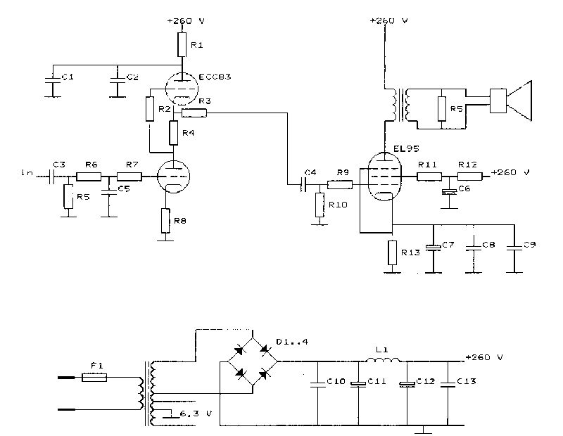

Thanks for the input. As matter a fact the inputsignal are already directly applied to the volume controls. I have removed the loudness circuit (cap and resistor). I will certainly look into the other options. For now it seems to be a good thing to check the item that was published in AUDIO&TECHNIEK as Jean-Paul mentioned,
therefore,
Jean Paul,
This seems to be exactly what i'm looking for to get me going!

Netlist,
Any particular type/make I should use ?

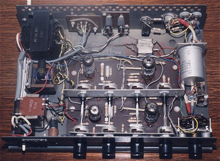

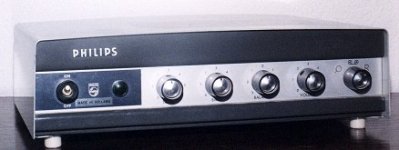

Here two pictures of the amp (not mine, this one already has the cinch-mod),

> <i>Schematic (i tried to attach it but it is too big)</i>
Open it in a graphics editor and down-size it to no more than 600 pixels wide. Many schematics will not stand such reduction without getting blurry; this one does if you bump the contrast up. BTW, there is little point in ZIPping a GIF or JPG file (unless you need to trick a free web server, or want to keep several files together in a package). GIF and JPG are already compressed, ZIP won't make them smaller. For on-forum posting, it is nice to crop-off excess or redundant details: I omitted the second channel and the selector switch to make this (I hope this works...):

Hi PRR,
Thanks for your trouble on the schematics!
