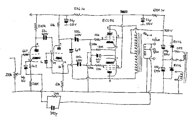

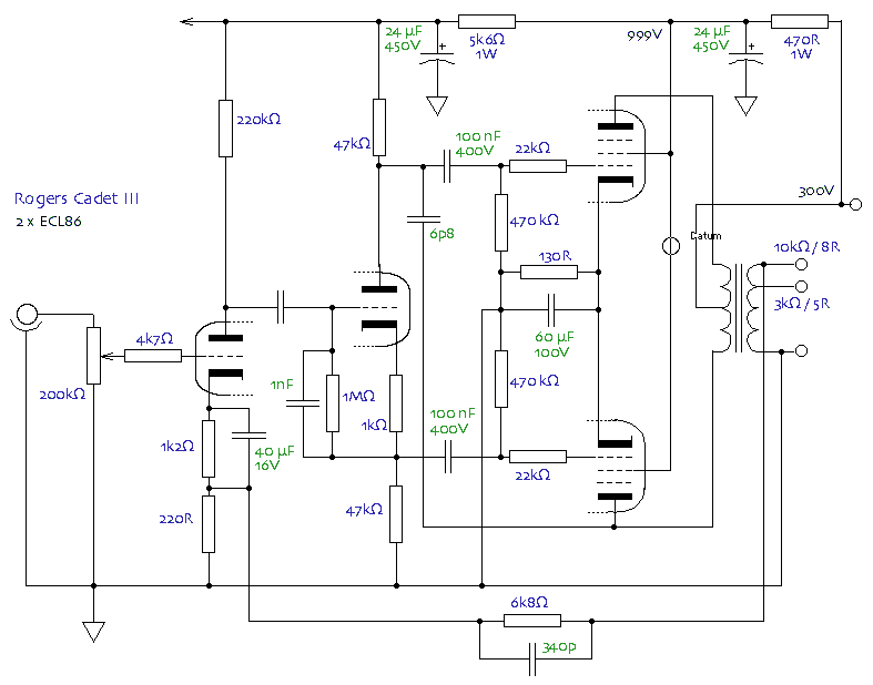

EC8010 said:I'm afraid it's rather scruffy
and real hard to read... corrections please.
dave
The transformer is a 9k plate-plate type. At the secondaries it has connections marker as 10/16 K and 3/5 K. I think the K should be Ohm
The 22n cap at the anode of the first tube is not labelled in the new drawing.
The supply diodes, resistors and caps are not drawn in the new drawing.
Some electrolytics are not polarized in the new schematic.
Tube types and pin numbers are not written. In the original schematic the preamp/phasechanger is not written as well.
The cap at the cathodes of the ECL86's is 40 uF 16 V in the original drawing and 60 uF 100 V in the new one. 100 uF 50 V is a better choice I think. Sorry for invading the Tubes section !

Just so you'll see we're paying attention..
390p not 340p
first 40u should be polarized
60u should be 40u and polarized
pot should be 250k
The omega sign is just plain "showing off"
Oh. where's the power supply?
enough for now - nice drawing

Sorry about my writing, Thanks for that, your drawing is much nicer than my scribble. Since buying a computer, I am no longer licenced to wield a pen. The feedback capacitor should be 390p, rather than 340p, the volume control is 250k, rather than 200k, and the 40u on the output cathodes is 16V rated. The coupling capacitor between the first two valves is 22n 400V. As Jean-Paul says, the output transformer is 9ka-a matching into 10/16R or 3/5R (my R's have a tendency to turn into k's, but it's better than talking through my k's). Their power supply is horrible, so leaving it out is just fine!
