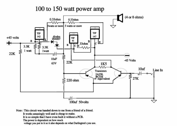

This is my first posting in here - so be not too strict with me 😉
I just found this schematics on the web.
Can anyone tell me, if it's worth a try?
I just want to build a really simple amplifier. It don´t have to be with shortening protection or anything like that or dc-protection for the speakers.
If you have any other good and simle circuit which runs on +/-45V let me know, please 🙂
A couple of comments:
Sneak another 1N4007 in series with the other two so you end up with a string of three diodes.
Add a 100pF cap from B to C on the TIP41, that may be too big, but better safe than sorry.
Heatsink the outputs real well with either grease and mica washers, or rubber insulator pads.
The 27K on the input would be better if it was 22K, less chance for DC off-set.
Lower the 1K5 on the input transisors to 1K.
And very important: you must add a 0.1µF cap in series with 10 ohms and then put this combination directly across the speaker out terminals.
I expect this will do 75W at 8 ohms. I wouldn't run it at 4 ohms without reducing the supply voltages.

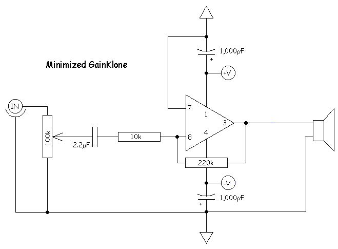

Example of very easy/simple circuit which you will find there, and can work from 45-0-45 (with LM3875 for example - which you can get as free sample 😉
Thanks for this circuit - maybe I´ll give it a try. But occuring to the datasheet it will "just" have 56 Watts on 8 Ohm which isn´t very much on +/-45V...

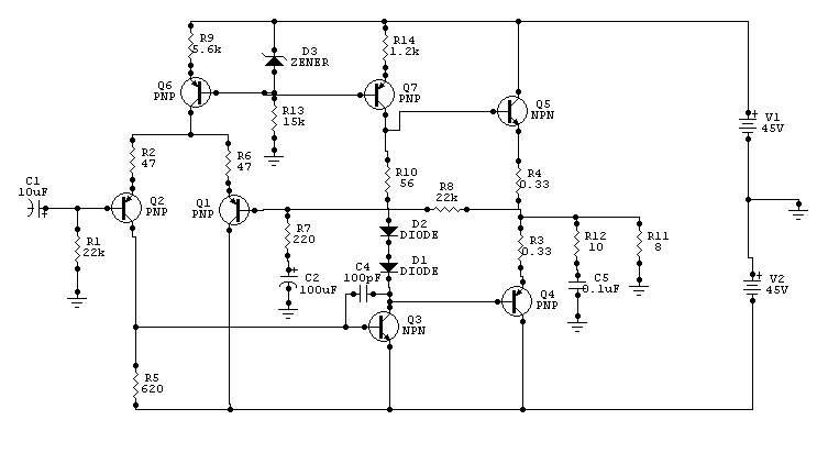

I think a forward-biased LED would be better than a 12V zener, or you'll lose lot of drive in the positive direction, the output would probably clip at already 30V or something like that... the resistor values will have to be changed in that case too. I also think a LED is less noisy than a zener.

lm3875 cannot run off of 45-0-45 ..
that's 90V, its max being 84V, that's a little too much
i wouldn't recommend more than 40-0-40 ..
just thought i'd clear that up 🙂
"Just for me as a newbie, why is this so important?(0.1µF+10R)"
If the amp doesn't 'see' a load at high frequency it can oscillate and blow up.
"What about using BD249/250 for the TIP142/147? Seems they can handle more current and are also Darlingtons..."
The TIP142/147 are plastic and rated at 125W at 25*C, in a real amplifier I wouldn't expect to see them run harder than 60W for the pair.
If you could find some 200W plastic darlingtons I wouldn't run the pair harder than 100W, and be sure and look at the secondary breakdown curves too. The TIPs start to fold back at 30V, even though they are a 100V rated part.
And when I say 60W or 100W I mean into the lowest impedance the amp will be expected to drive. If you make the voltage high enough to do 100W/8R you will not be able to drive 4R with only one pair of outputs. If you set it up to do 100W/4R, expect to see about 60W/8R

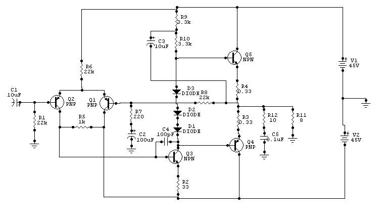

hugobross said:
so this is what the amp looks like (after djk's suggestions):
best regards,
HB.
OK, I just built this circuit...
Testing it with +/-30V and 8 Ohm speaker by low power (approx. 1 Watt) sounded quite well. TIPs were going to be just lukewarm with no heatsinks mounted on them ;-)
So, when I have a little more time, I will plug the circuit to my +/-45V supply, test it with heatsinks and more power.
good point! never thought about that!! with a LED instead of a zener R14 will be something like 68 ohm, and R9 something like 350 ohm. What's again the forward voltage of a LED, I think it was 1.4V right (for a red one)??
