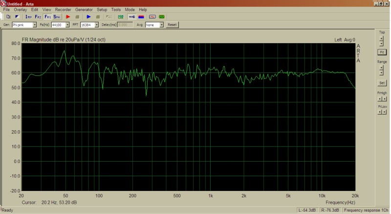

Anyway on to the 2nd type: Room EQ. Basically measurement taken a sitting position and equalised according to that.
Green is the equalised response. With software parametric EQ it is easy to make changes and listen to the difference. But the problem with this type of approach is high-Q peaks are almost impossible to identify. They would be diffused by the room and showing up as broad peak.
Take an example: If a driver is exhibiting high Q peak such as those metal cone resonances, they would not be picked up by the microphone at listening position as the original peak. Thus the equalisation applied will be wrong.
"Playing" with the parametric EQ also is difficult. The graphs keep moving and at best the result will only be close approximation of what should be. My ears couldn't judge what's correct and what's wrong after few minutes.
I found out this method is not good.

I've been doing room EQ just this last week. I've been getting excellent results - not subtle differences. I use 110ms gating time, so basically ungated. I place the mic at the listening position, but next I'm going to try spacial averaging to see if I can spot low Q peaks/dips. I use soundeasy's mls signal, and the results are very repeatable.
My graphs look a bit rougher than yours, even though I use 1/3 octave smoothing. Are yours smoother because of gating? Just guessing off the top of my head, I'd say I EQ'ed out some peaks with a Q of 3-5. A thought I had was that dipoles take ungated EQ well because their off-axis reflections should be spectrally similar to the on-axis.
Just a thought. Let us know how it progresses.
Hi Cuibono, thanks for your info. It's great to compare notes.
My measurements are ungated in these case. If you are able to spot peaks with Q=3 to 5 that's really impressive! The best I could do with this method was 1.4. Anything above that i could not spot.
I'm not sure why your measurements would be rougher. I am attaching here almost similiar measurement with no smoothing (1/24 db) and even that the trends are visible.
