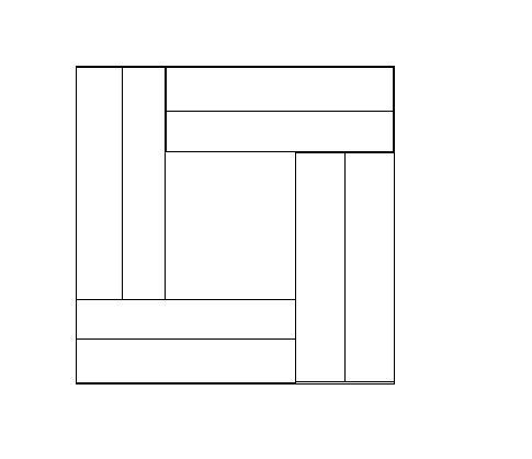

A weird idea ... 🙂
What if one were to configure an internally-partitioned tower as shown?
Let's dub it the "Quad-BIB" - the idea being that 4 BIB-style compartments standing together?
(Leave aside the size implications!)
If one were to use (say) WR125ST's, and kept to the calculated L and Z, what would the effect be (sonically) in squashing the X-section to make a reasonably-sized and aesthetically-pleasing compound cabinet?
