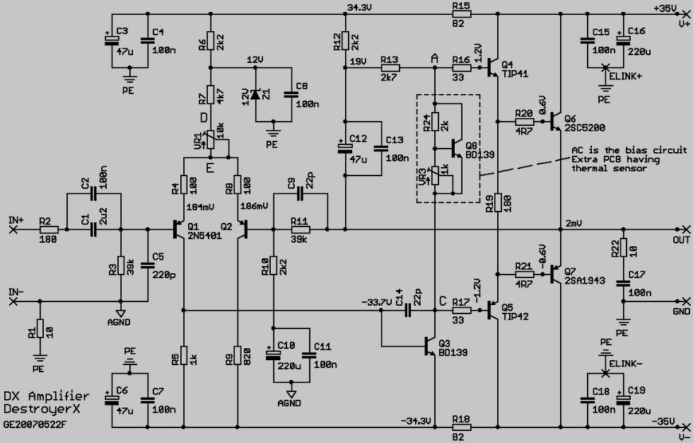

Here i will post images to help builders.
If needed, more images will be added, depending people needs

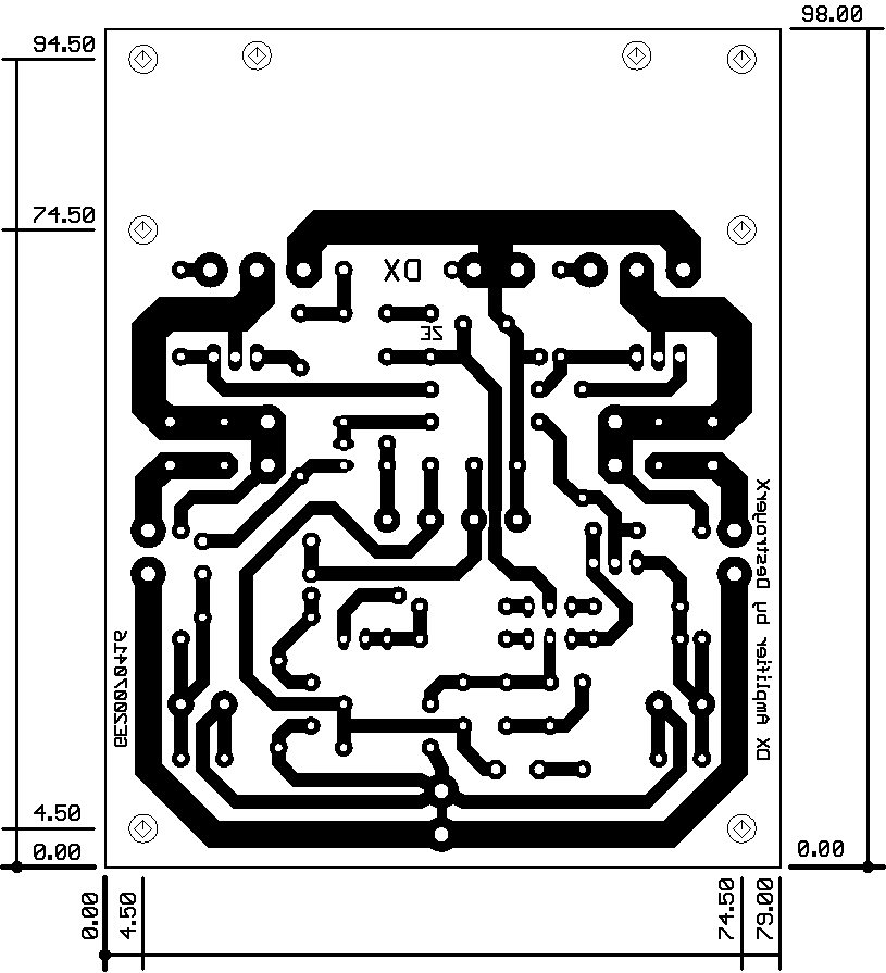

Here is the baby... assembled by Greg Erskine
The one have designed the board

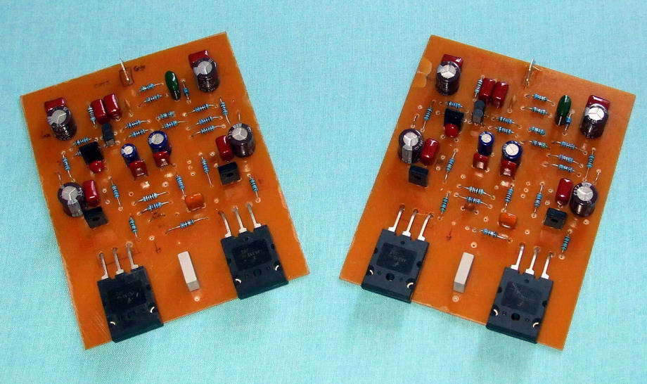

Here you have twin boards, home made, by
Klaas Veenstra
Klaas Veenstra
Here you see boards in transparency
This will allow you to conclude the image size to your etching.
Again... a nice work from Klaas Veenstra

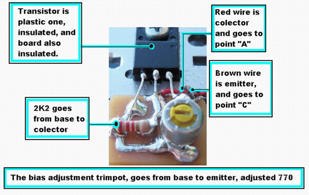

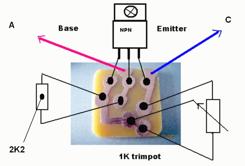

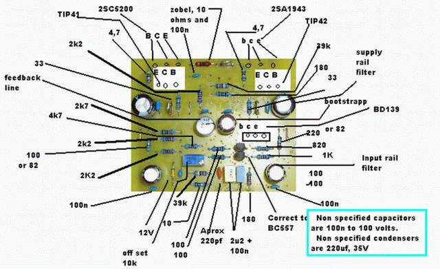

You have detailed instructions to adjustment
also parts list (bill of material) and more details into the Greg home pages dedicated to Dx amplifiers.
http://users.tpg.com.au/users/gerskine/dxamp/

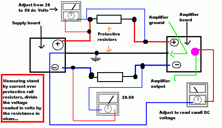

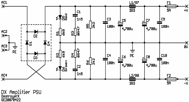

Suggested supply to the Dx amplifier
Each channel sucks 2.5A each rail from the supply.... 5 amperes will go to speaker (4 ohms).... 5000uf each rail.
So, this suggested supply is good to use together 2 channels if you operate those channels with 8 ohms speakers.
If you decide to use 4 ohms speakers, them double the electrolitic condenser value....or use one of those circuits to each channel.
Two supplies are suggested, as this will increase channel separation, dinamic power and sound stage.

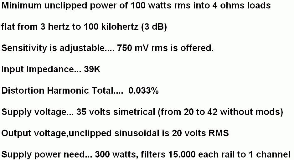

300 watts supply is enougth to 2 channels
each channel will use 2.5 amperes fuse into the rails
each channel will have 5 amperes fuse into the output.
each channel will need 12.500uf to 15.000uf filters to each rail when operating 4 ohms

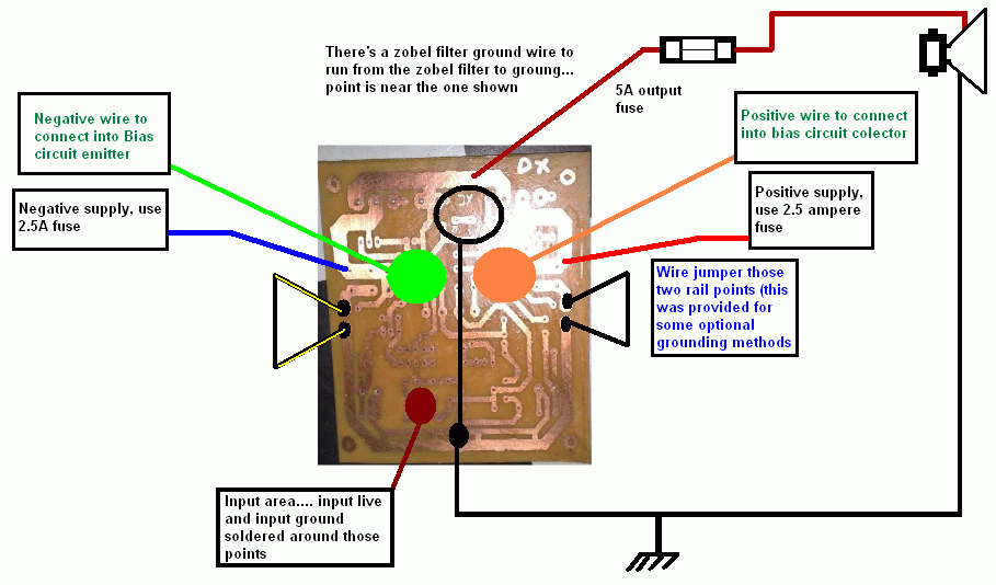

Grounding
the input ground (lifted using 10 ohms resistance) is exclusive the input audio cable shield.
main chassis ground is needed...bolt and nut or solder wire to the metalic chassis...near the secondary center tape and solder this center tape into this ground.
Run wire from this point to the board ground, to the electrolitic condensers central point, to the speaker ground, potentiometer metalic caps (if wooden panel is used..a non conductive panel) and heatsing must be grounded too.
Attention to the input ground .... the ground connector into your RCA input cannot be grounded into the main ground..this ground..the input ground, is insulated from the main ground.
Power transformer primary is fused too.... use 2 amperes to 220 volts mains, or 4 amperes to 110 volts.
