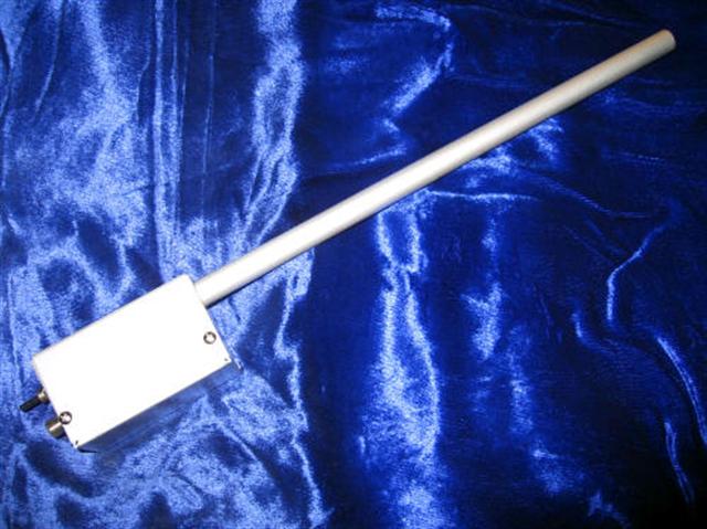

I just received some panasonic wm-61a modules
http://www.speakerbuilder.net/web_files/Articles/diymic/diymicmain.htm
gonna try doing that. Anyone else in here been down this route? impressions?

I've built the linkwitz mic - its easy and cheap. AudioXpress has a recent article on its distortion profile (which is pretty decent), and Kim Girardin calibrated one for me for about $40. Highly recommend, very helpful guy. kmgrdn AT luminet DOT net
Total cost? Like $60 for a very nice calibrated mic. What more could you ask for?

I started off by building the Jason Neal mic preamp, and later modified the capsule to Siegfried Linkwitz's mod of the Panasonic capsule. The mod is intended to enable higher SPL measurement and lower distortion.
The earliest comments I heard regarding the Panasonic capsules (and I guess the same applies to ECM8000) said that it was flat enough where it matters. That is, in the typical crossover region. So one approach could be to only use these mics (if uncalibrated) in the, say, 200Hz to 10kHz region, and not worry about the data outside this region. This way you trust system response outside the 200Hz to 10kHz region, having selected good drivers and done careful LF design. What I actually did was to borrow a generic calibration file that I found floating on the net and used that...
Take a look here:
http://home20.inet.tele.dk/audio/Measurement_Mic/microphone.htm
Think it works realy fine
