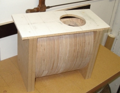

My sister wanted a pair of new speakers. Have to be small, bookshelf, but enough SPL for small room (20 sq m). After some searching and consideration, I settled for a 6.5 litre bass reflex with the Alpair 6.
The pipe is 36mm ID and 103mm long (excluding the bellmouth). The form and construction is well known. No BSC, but a 4ohm 10W metal film in series, for now. Outside dimensions approximately 200mm x 276mm x 305mm. Walls lined with single layer of sonofil.
Here is the prototype unfinished (still need to sand and spray).
Absolutely gorgious thing (and not only the look). Thanks to MarkAudio for a great product. We are going to build 10 pairs of these.
We'll publish open-air measurement when we get a weekend without rain and with free time.
Patrick

It'll take us till July, or later, to be able to posted everything, including measurements and pictures of a full finished article (with custon design stands). In the meantime, pls bear with us.
Patrick
PS One thing we shall not publish is the drawing, to avoid us getting into trouble with a certain speaker manufacturer.

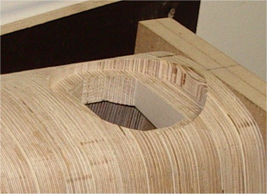

Mill a counterbore on the front surface to suit the flange of the chassis, with a R8 fillet radius.
It does not show up very well on my photos because of the plywood pattern, but I hope it is clear enough to get the idea across.
Patrick
