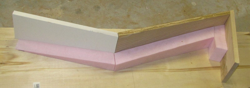

Jem - I think the two tapers are equivalent area. The advantage to the second is that you only have to fit one board instead of two.
In the interest of saving a thousand words, I've attached a picture of a mockup of the wedge done with scrap wood and Styrofoam.

Dave - any thoughts on a Styrofoam wedge? It would seem that if Styrofoam is OK to reduce the size of a CC that it should also be OK in the throat - or am I all wrong on this?
The really heavy duty styrofoam they use for building insulation might work, but i'd be more comfortable with solid. This is a place where MDF is probably OK. When we built the wedgies, the wedge was a real pain to do.
dave
dave
The wedge in the mockup went together really quickly; no more than 20 minutes. Granted it's Styrofoam, but I cut it with the same power tools I would use for a solid; a miter saw for the short angles and a bandsaw for the major slope. The bandsaw is a luxury but as I mentioned before,a jigsaw should work nicely too
I think this wedge has some advantages over the original frugel "wedgie"; The short angles are 30 and 15 degrees - easy to set up and the the major slope is only on one side which is easier to cut and fit.
