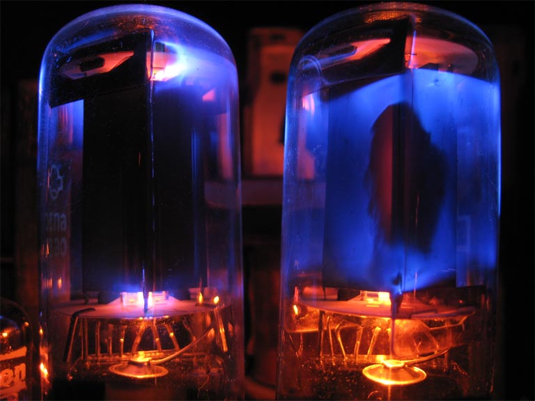

Blue, blue, my tubes are blue. (6JN6 and 6LF6)
I must be doing something wrong, my tubes glow red!😀
