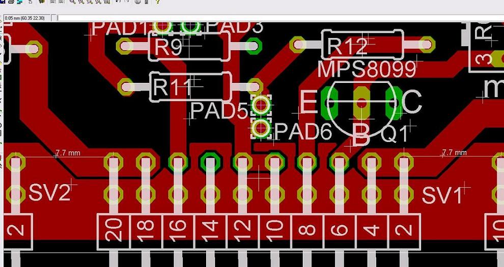

Also if you could post the pin out, spacing of the connectors and voltage limits I might want to buy a "driver board" but design the front-end myself. I was also currently working on a "plugin" amp but this would speed things up.
I use standard 2.54 mm pin headers (two 2 x 5 and one 2 x 10). The image shows you center point space. Is it okay? The board can actually be used for any voltage within LME498xx limit.

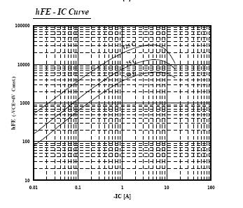

Dear All,
Interesting,
I wouldn't go without driver transistor with any BJT because the current gain of BJT's is to low.
But if you use Darlingtons with a hFE of 5000 (like the Sanken STD03's) you can use multiple pairs without adding a driver and still keep maintain low THD. This if you want to keep simplicity.

Interesting,
With best regards,
Bas

Dear Andrew,
I am very aware of the very bad reputation of Darlington designs. I remember Rod Eliot also hates them as he point out on his website.
Sure a Darlington is in fact a BJT with integrated driver but it saves PCB space and tracks, that was my point with "simplicity"
For the rest I can only say to all those Darlington haters, put your pre judges away and give it a listen.
Those Sankens got used in almost every Musical Fidelity amplifier in the nu-vista line. All Arcam amplifiers use them and along them many others. They all got excellent reviews and really sound good.
I was hesitating to design with Darlingtons, but the STD03 seems to be a huge surprise and sound really really good.
With best regards,
Bas
panson_hk said:The Sanken STD03 current gain vs Ic looks very promising. I believe how we use them is most important. However, having the output device modulates the driver temperature is![]()
Thanks you Panson, I tried to upload the same image but it failed.. the hFE curve isn't bad at all, and I think people should put aside their pre judgements for Darlingtons and give the STD3's a serious listening. 😉
With best regards,
Bas
