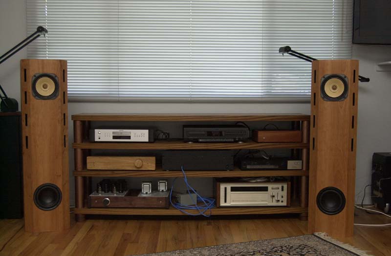

I moved the new Fonken167s up to the living room yesterday, and thought I'd post a few thoughts and pictures. These are floorstanders with Easttech bass drivers in a 14L box in the base, for some added help at the bottom end. I haven't hooked up the bi-amp setup (just casing the amps) yet, so the bass drivers are just decorative at this point. These boxes are very fine-sounding, and definitely a 'step up' for the 167s in my (modest) system.
First, a big 'Thanks' to Dave at Planet10 for the plans, advice and couldn't-be-beat deal on the bass drivers.
Contact Dave for plans and info, as well as 167 enhanced/modded drivers and phase plugs.
John

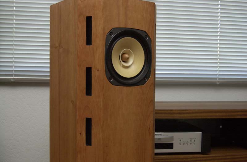

Construction-
As per the plans, the boxes are 18mm Baltic birch plywood. Heavy stuff though not as bad as mdf , so you will be glad to get the 5x5 sheets ripped into smaller panels if you have limited working space. Wrapped in cherry wood-backed veneer.
I wouldn't rate the boxes themselves as difficult to build, though there are quite a few parts and you need to think through the assembly sequence. However, they are difficult to get a very clean finished result, as the vent openings and trimming the veneer give lots of opportunity for 'cosmetic' mistakes. (I made plenty). If you can be happy with a flat or textured paint finish you can save yourself a lot of 'fussy' work, and the sound will be just the same.
Cutting the bevels on the front corners was not very difficult with a 10" table saw with a good outfeed (and infeed) table. It will be worth your while to take an hour or two to set up temporary feed tables to keep these cuts under control and safe. The boxes are heavy and need good support.

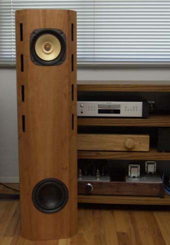

Veneering-
I hadn't worked with thin veneers for many years- I generally use sawn veneer on projects where I can't work in solid wood. It's obviously an area where a bunch of mistakes will be made before you get the 'knack' of working with the material.
This Australian publication is a great resource for techniques to use with veneer- both 'real' (thin/fragile) and sheet veneers. Modern sheet veneer like I used (4x8 sheet, wood-backed) is very tough and easy-to-handle compared to standard veneer, and eliminates the problems of joining and taping to cover large panels. However, the veneer layer is very thin - it seemed thinner than standard veneer- so you should take care not to sand through- hand sanding (if at all) is recommended.
I used the yellow glue and iron method on the veneer- I tried using my vacuum bag system, but had problems with uneven bonding- probably the glue was not thinned enough. For vacuum bagging Titebond makes a special veneer glue which might help (I didn't try it). A new $10 iron with a stainless base and 'shot of steam' feature was a help as well.
I found that the edges tended to have bond problems, so I ran a thin bead of CA adhesive along the overlapping veneer joint before trimming with a block plane and hand sanding.
Note- the wood backing on the veneer is a luan-type wood, which is softer than the face veneer, so the surface is easily dented- you will need to take care to pad your workbench. Just a 'touch' on the bench edge can leave a visible mark, and steaming out dents is problematical with the ironed-on veneer system.
The project took a few hours a day for about a week- so no instant gratification. Making the jig for the recess for the 167s took some time, and the home-built circle jig needed a few more holes drilled to match the drivers.
I'm happy with the result- these are very good-sounding speakers.
Cheers
John

Just a quick update:
While I'm working on the bi-amps and making decisions there (integrated input switching/volume or just power amps?), I set up a temporary bi-amp rig:
CDP/DAC --->Volume pot---->Passive XO---> Amps---> Speakers
feeding the Hipass to the 167s and the loPass to the Easttechs. I didn't like the result as most of the 'good, tight' bass wasn't getting to the 167s. So I changed the setup so that the 167s are getting unfiltered feed after the 'master volume' and the Easttechs are getting the bass feed after the volume pot and LoPass (around 300Hz).
Fullrange amp is MauroPenasa myRef, Bass amp is Dokorder800X.
Result- the Fonkens are still great on the jazz/folk/vocal stuff, but now can better handle rock. Also bass lines in general have more power.
BTW, as Dave mentioned in another thread- there will be no need for a trimmer on the bass feed- they need plenty of input to keep up with the 167s.
