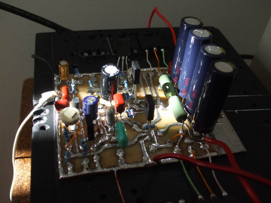

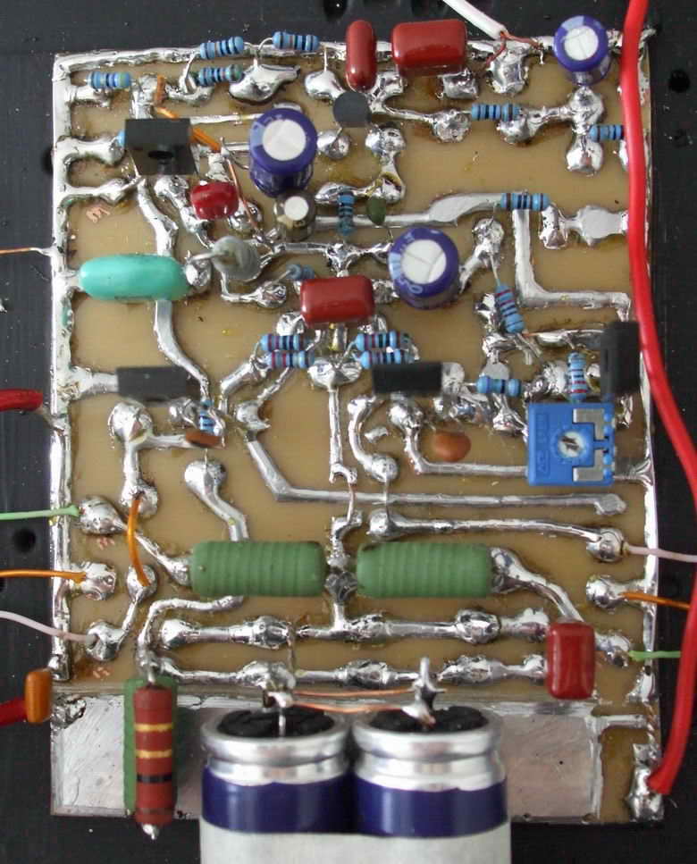

Trust is an old style amplifier, having the awfull condenser into the output....
... a scandalous thing to many forum folks..sorry because of that.
It is not high power, as it is an old style amplifier..something based into the sixties and seventies amplifiers.... does not use differential amplifier.... very simple, also no symetrical supply.
I was trying it those last days...friends came to evaluate, also children...they felt them coloured but delicious and pleasant sound..the same i have perceived.
Power is not more than 20 watts into 4 ohms and 10 or 12 watts into 8 ohms... this can increase if you use 70 volts non symetrical power supply (Dx supply modified to give you 70 Volts instead of 35 plus 35 volts)...and them power about 70 to 100 watts will be possible.... just will be needed to adjust the input transistor base resistances and to re-adjust the bias trimpot.
It is working class AB..and very low biased.. output emitter resistances are draining some miliamperes only (5 to 15 miliamperes)... frequency response is awsome and simulator results are excelent.
Enjoy a new Dx Amplifier...this one, the Trust, is a delicious amplifier.
Has an advantage...if you have burned parts because some accident, or continuous overload...the speakers will not be damaged, because the output electrolitic condensers are there to block any DC to the speaker.

I have just tuned the amplifier for sonics
and in advance to give you the schematic i need to observe what happened into the simulator with my modifications... sonically i know..but i want to know about numbers too.
Soon i will give you complete PDF schematic.
For a while, listen the youtube video and watch this simplified diagram without values.
I have made modifications, includding more parts, more capacitors and i want to know what happened into the fourier and about THD and also frequency response.

I'm surprised you still use the miller compensation cap, usually this kind amplifiers can go without it. Anyway, I like these kind of amplifiers 😀
This one oscilated as a hell without the Miller
in the reality i was using 30 pf and had to increase to 100pf to stop the oscilation.

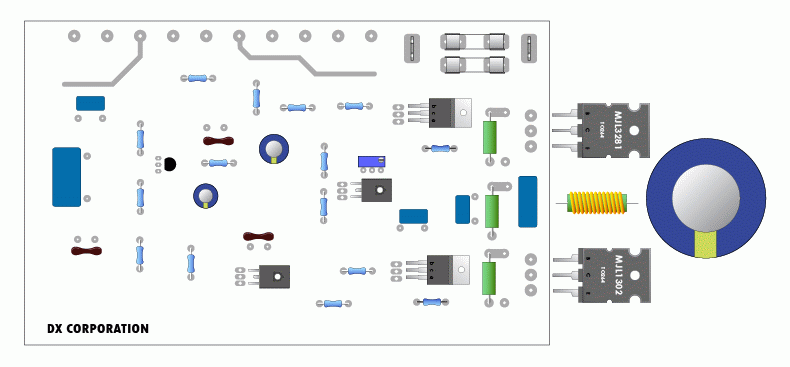

Of course i will be happy with someone building and enjoying
Also publishing his evalution.
I need contribution...someone to produce boards...BUT...there are fules and regulations from the Dx Corporation Headquarters (ahahaha).....
Layout must be submited to the chairman and forum folks to evaluation.
Must be small.... better if squared.... an idea is shown.
The one that produce the layout must assemble the board to be sure it works
The one that produces the board must offer layout from the copper lines and air view from the component side.... informing board sizes and offering a black and with option to hot iron board home manufacture.
Resistances are all 1/4 watt.... condensers are the size and type you want..voltage is 35 volts or more if you like...capacitor material can be ceramic or other material..board can be fenolite or fiberglass.

I will be designing a PCB for this amp to replace my Dynaco Stereo 80 PCBs. But this will be a 70 volt version (to use the Dynaco's existing power supply), and the PCB will be fairly large and made to fit exactly the Dynaco chassis.
This will only be of interest to people who want to retrofit an ST-80, so I will create separate thread for that project when the time is right.
..Todd

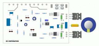

Here is a board idea.
You have only to not paint the parts..they are there only to help you to solder parts... this is made to solder into the copper side..but you can use it to prepare the board to use components into the standard, more common used side too.
Schematic lines and black dots to solder component leads are keept, the parts are removed, and the sketch will be usefull when you start to assemble...as parts position and values are there.[
ALL IN ONE!

Brother Charlie, Boss...
I will gladly do a nice schematic for you.
But I will only create Dynaco-size PCB, not a "standard" one. Mine will not be interesting to most people. So we will need to get another DX department to do the normal PCB.
My "lab" is still not open, so I won't be building for a time yet. Only drawing for a month or two more.

VBE multiplier special case (a thermal sensor
And a bias adjustment circuit into the same
Transistor that goes attached to the heatsink)
VBE = 642 mV or 0.642V
VCE = 2.28V
This circuit, the VBE multiplier, can be substitute
for testing purposes, by a single 500 resistance,
and the unit will be soldered into the previous
VBE multiplier colector and emitter places.
More details about the Trust amplifier
THD at 10khz – 1W – 0.02%
THD at 10khz – full power – 0.025%
THD at 20khz – 1W – 0.08%
THD at 20khz – full power – 0.072%
Current into first stage:
Base current – 100uA or 0.0001A
Colector current – 680uA or 0.000680A
Current into second stage (VAS)
Colector current – 4.55mA or 0.00455A
Current into drivers
Colector – 5.32mA or 0.00532A
Current into the output (adjustable)
15mA or 0.015A
All transistors, exception is the power output)
stand by base to emitter voltages (VBE)
640 milivolts or 0.64V
Power output transistors VBE:
550 milivolts or 0.55V
Voltage measurable over power emitter
resistances (0,33 ohms, inductive – 5 watts)
5.2 milivolts or 0.0052V
VCE = 2.28V
