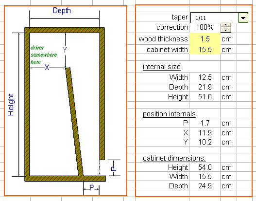

something like this? (this example is tuned at 50Hz)speakrsrfun said:......I'd like to also investigate a destop Transmission line for a single CHR-70.

That's a nice design, Henkjan. The taper is a little severe, IMO, but I imagine the bass output would still be tunable.
Personally, I like the idea of a dual chamber reflex with dual ports for a desktop or bookshelf. Models show a very nice response in a net total volume of ~7.5L. It would help with power handling for the single driver implementation.
Speaks, 35L does seem large considering 10L is the recommended size by Mark. If you want a floor stander, consider it as a ML-TL. That might be more feasible.
