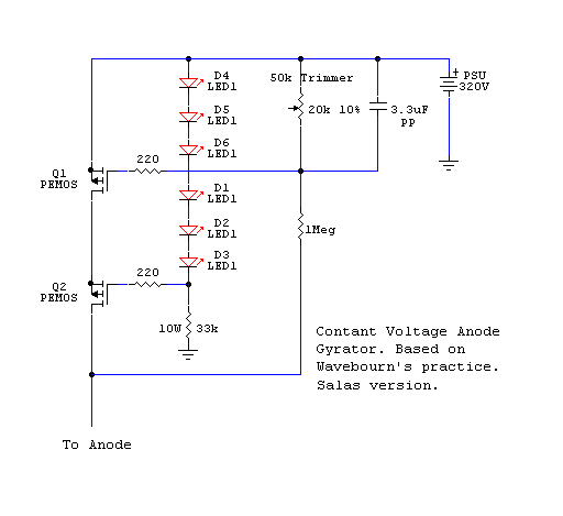

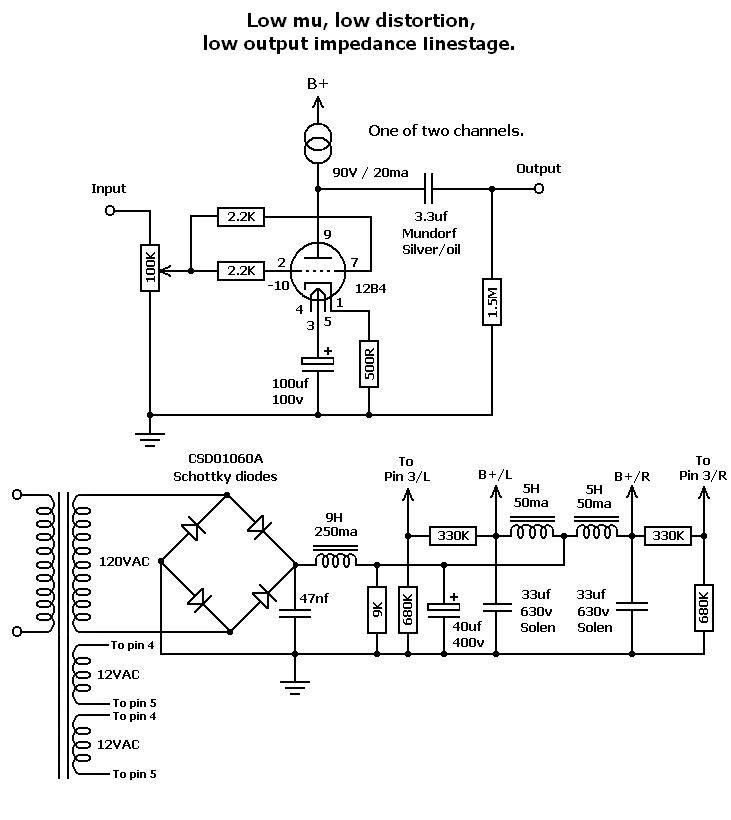

I'm attaching my version of a 12B4 line stage. I used CCS loading, which allows the NASTY 10 KOhm IHF "standard" load to be driven.

No, I like the sound as it is since it does not have a microphonic echo. Just to inform those who haven't experienced a 12B4 and may think its ''dead'' due to low mu. The big hot cathodes are sensitive.
I have used a cascode Mosfet CCS (enhancement mode) with plate at 160V to ground, 1k2 cathode resistor BGNX bypassed, with 18V across (15mA). Up to 20mA is OK. Also tried Jung's 317 10M45S cascoded. But best sound is with constant voltage enhancement cascoded Mosfet Gyrator based on a Wavebourn's idea. But with a 12B4 care is needed to PSU decoupling unless the whole active thing reacts and blows serious hiss. With resistor load is easier to keep tame. Active loading pushes the Mu and if there are hidden gremlins they come out. FFT scrutiny is advised during building.
You have several CCS options:
Gary Pimm ccs http://www.pacifier.com/~gpimm/self_bias.htm in the anode (in my view the best sounding option)

Because I have tested all you mention except the G.Pimm. I recommend you to try the constant voltage gyrator. It sounds different (to me clearly better). Wavebourn uses the principle, we talked about it during an anti-triode CCS discussion. I have put together this one and Wavebourn inspected it in that thread. Gave the green light. If you use a regulated B+ common between channels, see it does have a low output impedance between 20kHz to 50kHz. The gyrator is constant current on AC, constant voltage on DC. Its an electronic choke as you know. It will just keep your B+ at half or about. It is not like changing points by varying a CCS. B+ choice is the key so to hit the bias you look for. I think you use depletion a lot, may you can come up with something without LEDS (needed to turn on enhancement mode) possibly? I haven't looked in to it yet. Talking about the LEDS, they don't connect to the top Mosfet's gate at all on the circuit shown, they turn on the lower one only, six of them. I mention the obvious bcs on the schematic it may be read as a possible junction that I forgot the dot.🙂 The upper divider resistor turns on the upper PMosfet. Its a servo loop with the anode. It gives double the dynamic headroom than a CCS when nominal current is reached. Like an SEP anti-triode at that.

Before you change your B+, try 160V on anode to ground at 15mA. Its a very nice point.

I like your stage--simplicity in the max. I especially like the low voltage--in fact I was hoping to find that a simple isolation transformer could supply B+.
I threw a CCS together and measured the differences to Basic GC. 2nd harmonic distortion rejection is about 4 db better than GC at 255V--very nice. 3rd harmonic remains about the same. Square response is good--not quite as clean though. Gain is better by a little (obviously) do to ultra high AC resistance delivered to the plate. I ran mine at 21 ma, 120V B+, 110V to Plate. All in all, a very nice solution. Falls apart at about the same input voltage as GC, but with higher gain comes closer to goal of 2V output.
One potential comparison would be a choke fed anode resistance at the same voltage and cathode resistor of 500ohms and in the CCS design above. Gain is close to same as CCS and 3nd Harmonic distortion in better by about 4 db! 2nd harmonic is comparable and down over 60db. I'm a big fan of choke anode loads, so I'm going to proceed with this.
Next thing to look at is tube based voltage regulator. With only 120V required at 20ma, 0B2 for each channel could be an option.
An acquaintance made that drawing from a narrative I provided. The values shown reflect stuff in his "junk box".
For a builder starting from scratch, I recommend a Triad N-68X for B+ and a Triad VPL24-1100 for heater power. That inexpensive (total $21.73 from Allied) "iron" will get the job done in both "120" and "240" VAC household power zones.
The pseudo choke I/P filter shown is reasonably well regulated, on its own. Adjust the "fudge factor" cap. to bring the rail voltage in (under load) between 120 and 125 VDC. The most expensive part in the design is the 1st PSU inductor, which must be "beefy".
BTW, cheapskate Eli thinks in terms of a film and foil bypassed GE 40L3501 MPP part for the O/P coupling job. Mundorf caps. are very nice and very expensive. The Law of Diminishing Returns applies here.
