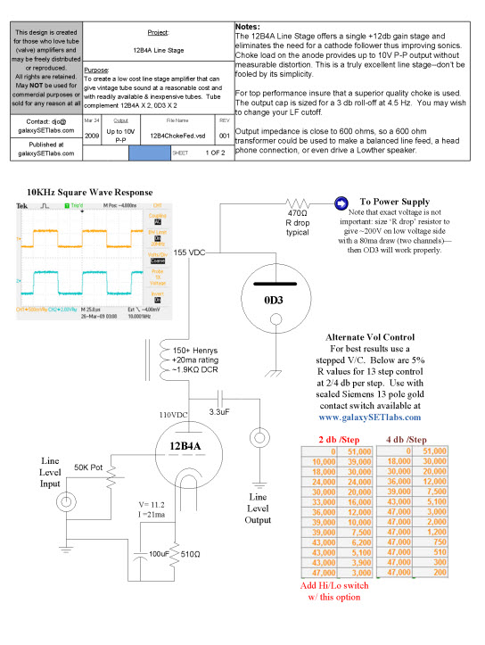

Final testing on 12B4 Choke fed design
Final test for this pass (maybe first--maybe last) was to try voltage regulation with the choke fed design.
First attempt was an 0C3--but the voltage was too low at plate. Changed to the 0D3 and the plate voltage using my 150H choke, gives 110V at the plate: Just perfect.
Checked out the performance--and I'm convinced. The input voltage before break up is almost 80% above the CCS design--660mv RMS, giving a clean 3.6V RMS or 10V P-P output. This is excessive overdrive capacity. Distortion at the same operating points is unmeasureable on my FFT, and the 3rd harmonic has mainly dissappeared. 10KHz square wave looks wonderful.
There is something to be said for simple, old technology. I'm going to build this and see how it sounds.
Final details are as follows:
Textbook Grounded Cathode design
Paralleled 2.2K resistors input to grid
Cathode resistor = 510 ohms, 1 Watt minimum
Cathode Current = 21ma, Vg=-11.2
Anode Choke = 150 H, 1.9K DCR
Regulator tube = 0D3, 155V regulated
Voltage at Plate = 110V
Gain = 5.5, Max output = 10V P-P
I'll get it drawn up and post it in the next few days. First need to design the power supply. With the OD3 requirement my hope of just using an isolation transformer has died. Oh Well.
For those who need parts (12B4's & chokes) I'll make them available on my web site. I have my chokes built for my by a master designer in Hong Kong who ships them in bulk to me. His quality is excellent--easily rivaling Electroprint or Tamura.

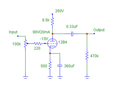

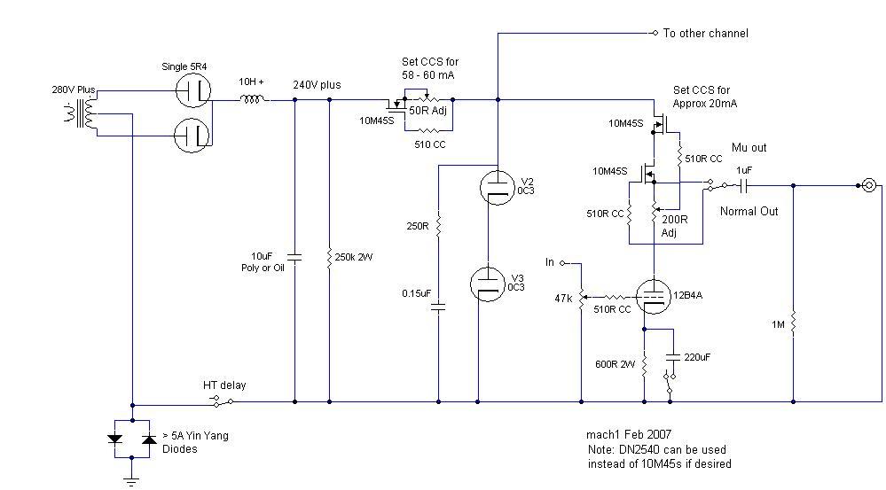

If I would like to use a grid bias battery in the schematic posted by mach1 a few posts above this one, does the battery have to be re-chargeable ? Some batteries (Lithium?) explode when any form of charge is applied to them if they are not re-chargeable. (A cathode bias battery would of course need to be re-chargeable.)
bequerel said:If I would like to use a grid bias battery in the schematic posted by mach1 a few posts above this one, does the battery have to be re-chargeable ? Some batteries (Lithium?) explode when any form of charge is applied to them if they are not re-chargeable. (A cathode bias battery would of course need to be re-chargeable.)
I know for sure that the cathode bias battery do not require recharging because the are being charge while in use... use a rechargable battery here and you are saft from any explosion.

Yes, the cathode battery operation is OK, the question is the grid battery.
I am not worried about having to re-charge, but if the battery will explode if I use an ordinary battery on the grid.

The 12B4 is a great starter linestage. As to you power supply it can work fine with this design (posted as a work in progress--I haven't completed the testing and listening). This design requires 200V at 80 ma, and a good power supply is absolutely vital. You can use various techniques to drop the voltage as needed and retain the speed.
I'll post the full size and design on my website later this week.

The linestage schematic I posted had a couple of minor errors (two dots indicating connections were missing) that have been corrected in this version.
