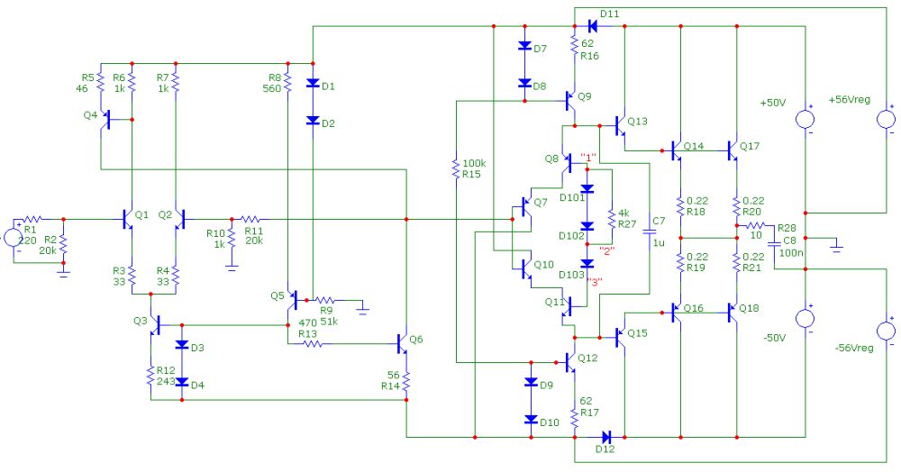

Hi all,
since the original Krill thread has become way too big I think that is better to start a separated thread dedicated to building questions and experiences.
This way the information for building a Krill amp will be easily available.
Attached the schematic for the 100W amp.
Some notes:
-R5 is actually a 100 Ohm fixed resistor paralleled with a 100 Ohm trimpot
-I omitted the 100Ohm//1K trimmers between the emitters of Q7/Q10 and the collectors of Q8/Q11 since these are not present on the boards.
-R27 is the bias trimmer
Ciao
Andrea

Hi Thomas,
I've completed one channel but I'm experiencing biasing troubles.
It looks like Q7 and Q10 get too hot and "cut" the bias. I'm not able to set the bias higher than 20mA/device at the moment without cooling them.

Andrea,
they each dissipate around 600mW, so maybe good heatsinking is required..... I guess the low Vbe at high temps cuts off the bias string completely. It is surely just a temperature effect.

Hugh,
I agree that the cause is most likely a temperature effect, but I'd like to hear also Steve's opinion about it, since he never mentioned the requirement for heatsinking (he stated that the BJTs run hot on purpose) and also because those boards were used for a commercial 100W monoblock amp.

Hi Andrea,
Q9 and Q12 should be running at about the same temp as Q7 and Q10. Is this the case? You should just be able to keep a finger on the transistors. If they are too hot for that, check to see that you have no more than 10mA through R16 and R17. I have not encountered this problem before. If the transistors are getting too hot and cutting bias, and all else checks out OK, you can either use a small heat sink on the transistors or increase the value of R16 and R17 to reduce the current.

boraomega,
Andrea is building the 100W version. The transistors in it will dissipate about 0.56W. Still well below the 2W rating.

Hi all,
a few replies:
-boraomega:
I knew the BJTs were meant to run hot but I wanted to know, since the 100W boards were used in a production run without reported problems, if something has changed (e.g the BJTs or their case) from the commercial project.
-Steve:
Q9, Q12, Q4 and Q6 are running hot too.
Do you think that the problem is related to a different Vbe characteristic of the (newer?) Fairchild transistors (I got them together with the boards from Thomas)
Ciao
Andrea

Andrea, your schematic posted here on post #1 is different from Steve's schematic, which was repeated here by Phil in post #9, so I wonder.
Joshua_G said:Andrea, your schematic posted here on post #1 is different from Steve's schematic, which was repeated here by Phil in post #9, so I wonder.
I know,
but mine matches the boards better and includes some corrections from Steve.
Ciao
Andrea

If your using R27 = 4K, you may not be able to adjust bias. R27 should have 10K, as Steve schematic.
I have one channel built and the other almost done. I am waiting a good chassis from Italy.
Andrea
R27 is a 10k trimmer. The 4K figure is just for simulation purposes, as stated in 1st post.

A note here on the differences between Andrea's schematic and the one I copied in this thread is appropriate.
Although there are some differences in resistor values and trimmers, it is important to note that the current sources (Q3, Q5, Q6, Q9, Q12 and their associated diodes and resistors) are the same in both schematics.
Q3 - 3mA
Q5 - 1mA
Q6 - 13mA
Q9 and Q12 - 11mA.
Fortunately, these transistors are labeled the same in both schematics 🙂
I used 0.7V for the 1N4148 diode and Vbe drops to calculate standing currents. The exact value isn't as important as the fact that I used the same value for all calculations.
