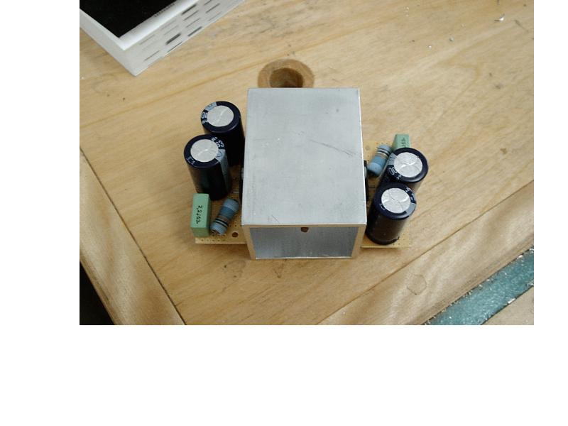

I built a LM3886 amplifier about 3 years ago.yeah, i've considered gainclone, however from what i've read is unless you use some high-grade components, you're bound to be dissapointed
At that time I haven´t heard about the "famous" gainclone.
I used a PCB-layout from a magazine which has twice as much parts on it than the layout most use here.
No hypercautious and supertight layout and neither so called high-grade components.
I still haven´t modified it and I have to say I really like the amp.
Which high-grade components do you mean by the way?
The only thing you could go so crazy with that it exceeds your budget are the capacitors and my personal opinion is that you can build it without Black Gates for example.
Most good companies for capacitors should be within your budget.

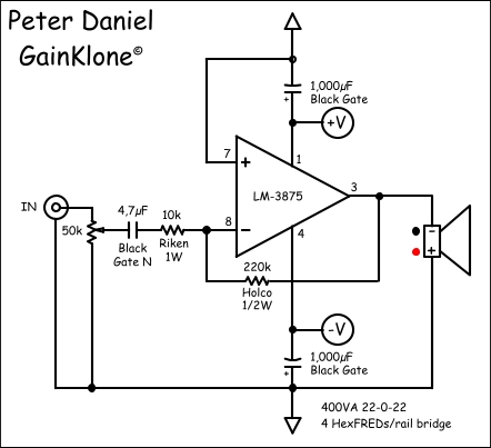

If you like Digikey then order the Panasonic FC 1000uF/50V for the filters. I do recommend you use a 4.7uF BlackGate N type for the input capacitor and a Mills 10K ohm for the input resistor. You can order them from Parts Connexion in Toronto. These components will cost you about $20US total vice $5-10 for other brand components but they are worth it. I use a Roederstein 220k resistor for the feedback but a good Dale-Vishay NH65 from Digikey will be work too. Don't spend to much on heatsinks use a 8" piece of 2"angle aluminum screwed to case will be sufficient. Stick with 18-24V transformers 120-180VA per/chan or a 225-300VA for both. The case depends on how good your metalworking skills are or buy one like cheap aluminum project box and paint it for super cheap. With the kind of money your willing to spend you could get a nice rack mount case 1U or 2U size and put everything in it. Good luck. It's a great project to cut your teeth on. 😀

The transformers are your biggest expense and you'll get under $200 easily. Just pay particular attention to the ground paths and keep your signal path as short as physically possible. Those have been most people's biggest headaches.

also, i already have a active preamp, do i just leave out the pot? or do i replace it with a resistor?

A 10 amp (5/winding) 18VAC transformer (10*18=180VA) 😉
A 50k resistor to ground instead of the pot would be the obvious solution but I have had some extra noise in my experiments using that configuration so I just made my amp an integrated version.
Peter, any suggestions?
