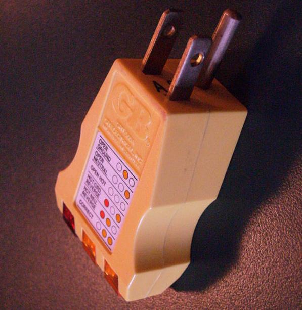

Here is one of mine (very basic & cheap):
AC Polarity Indicator
Cost: Around $5 at any hardware store.
Uses:
To check that your mains outlets are wired correctly with regards to Hot, Neutral, and Ground.
Benefits: Obviously for safety. Plus, I found that my audio gear sounds best when properly connected to AC Hot, Neutral and Ground(where needed).
Please list yours .
-Chas
