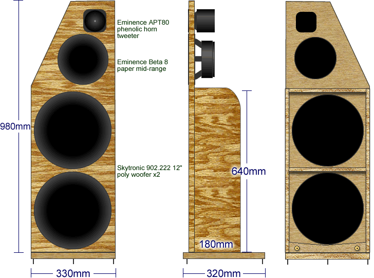

I've attached an initial sketch of how they might look.
Simon

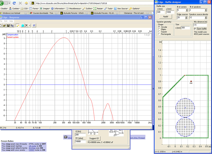

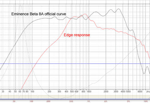

It has been noted that the Eminence Beta 8 has a rising response, but I've noticed this is almost exactly the opposite of the roll-off after the dipole peak in my speaker shape.
I think this response may very well be to my advantage. I've taken a screen shot from the Beta 8 official response curve and overlaid it on the same frequency scale as my Edge plot for that shape of baffle and driver.
See attached pic.

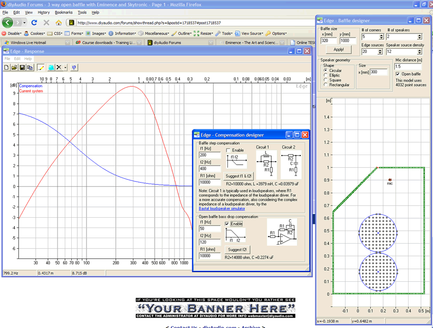

And here it is with some boost, to show (very, very roughly) what T-bass will be doing.
I think a 2nd order low-pass filter at about 100hz or so should be a good starting point to match up to the midrange.
I might invest in some speaker software to make filter design easier, but I'll be making measurements using ARTA at the very least.
Simon

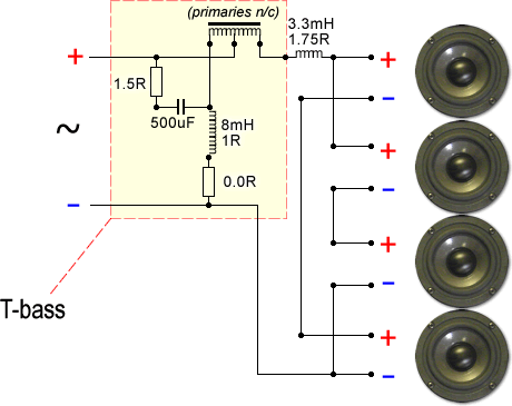

Here's an example of the T-bass circuit for anyone who's wondering what it looks like.
I've already sourced some 500VA 2 x 50v secondary Airlink brand transformers for the job. The low winding resistance should be ideal to achieve maximum boost and sound quality.
Simon

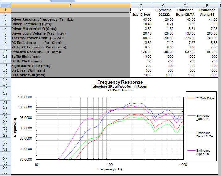

I've posted this twice before in other threads but it's very interesting - the X-Baffle simulation for some woofers, including the Skytronic ones I'll be using here.
See how I'll get a flatter response to work with from the Skytronic woofers than my previous ones (7" sub driver x4).
Credit to Thorsten Loesch for writing the spreadsheet and Panomaniac, as well as others, for putting me onto it.

Re: The midrange driver
That is a nice coincidence. Maybe they were designed like that, because many guitar amplifiers are open baffle, and 8 to 12 inch is a common driver size for them?
Simon I wonder if there is any way to raise the total "Q" factor of those Skytronic woofers without robbing them of too much SPL??
Adding mass will lower Fs and raise "Q" but at the expense of SPL/efficiency.
From the little work I've been doing a woofer Q of around 1 seems to be the best compromise; above that the peak at resonance uses up all of the woofers excursion and below that there is less and less bass as the "Q" decreases.
What we need is a dedicated 12 or 15inch OB woofer that we all can afford. Yes I know I've said it before, I need to learn to accept compromise.
I don't think the Qts of 0.49 is too bad - it's 0.09 higher than what I'm listening to now - and this works. At least it's a little closer to the ideal, and with bags more displacement (2 x 12" vs 4 x 7") so if EQ ever comes into it, they won't die on their bottoms completely. I'm going to get the speakers designed and built before deciding if any driver modifications or alternative drivers are required.
Remember - T-bass makes things possible that most OB builders haven't experienced with quite ordinary drivers.
In the UK at least, the Alpha 15 is the woofer you speak of, but I can't accommodate them in this room... just give me a few years to buy a house of my own :whazzat:

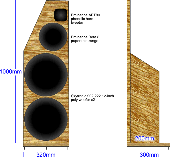

Here's a better sketch of how they might look.
I've now drawn the back up and made them 1cm wider to make sure the woofers fit on ok. I've reduced the side wings a fraction and altered the top driver layout a bit. I've also enlarged the plinth and made it extend out of the front.
I'd welcome practical, neat suggestions for adding mass and stability at this point.
Thanks,
Simon
