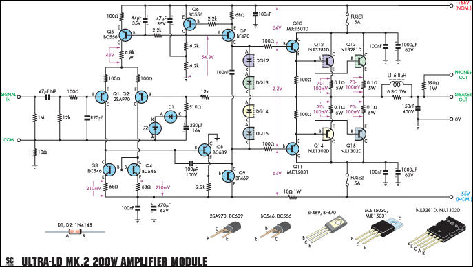

HI Anybody else built or had experiance this amplifier with the ThermalTrak Transistors ??
I have just completed 2 of these 200Watt LD amplifier modules (Jaycar kits) i have one problem, even with the 47om resister in Q7s emitter i cannot get anywhere near 7-10mV across any of the .1ohm emitter resisters mine all read around 2.5mV. with 30mv across the speaker terminals, (Rail voltage is +55.8 , 0 , -55.8.
The voltage acros the diodes (Q10 & Q11 base) is OK at 2.28Volts. All other circuit
voltages read Fine as per the article , & the modules seem to work OK, (listening as im am writing this ) sounds pretty good !!!!
both modules are exactly the same , so what am i missing here??
Are there any updates to this article??
Component variation problem?? or what
Thanks Mick Hawtin
Thanks Mick Hawtin
7-10 mV gives 70-100mA, which is normal
The diodes should create a higher voltage, the more current.
1. You can increase current in Q7, Q9. But not too much, cause they may overheat.
54V x VAS-current = power dissipation in those TO126, BF469/470.
With good cooling maybe we can use 2 Watt for those TO-126
2. A slight effect you could get from reducing BASE resistors of MJE15030/31 to 47 Ohm. (from 100Ohm)
3. Reduce current in drivers a bit will lower the voltage drop in drivers.
= increase EMITTER resistors of MJE15030/31, from 100 Ohm to 220 Ohm.
4. Parallel each 0.1 Ohm emitter, with another 0.1 Ohm, will double the current:
3.5 - 5 mV for ame 70-100 mA
These adjustments can all effect the operation of the amplifier.
How little or much is hard to say.

Below is the schematic of this Ultra-LD 200w amplifier
Another idea, which would make other changes not necessary,
is to put in one resistor with a suitable value in series with those Thermal-Trak diodes.
I do think this could work well 🙂
Lineup is on the right track.
4 series diodes cannot generate sufficient voltage drop to drive sufficient bias current through the output stage.
Adding a pot in series or another diode would allow a higher voltage and result in a higher quiescent current.
200Watt LD Amp
Thanks for every ones feedback on this Amp problem , i actually contacted one of the designers , John Clarke who came to the same conclusion that you guys did,
that is ,the fixed resistor in series with the diode string to increase the quiescent
current in the output stage, i finally ended up with a 7.5ohm series resistor for
8.5mV across the emitters = 85ma .
Amp running fine now , very stable , hopfully this will help some other builders who
may have the same problem.
Regards Mick

Great!
Now we know it is not that difficult to adjust bias of ThermalTrak transistors.
Using the 'simple resistor trick' 😀

Just mount the diode vertically in the general area of the LTP, or in this case,where you already have fitted the 130ohm resistor.
Why not just try it initially with a 200 ohm trimpot where the resistor now is?
Set it initially to 130 ohms. This series resistor will reduce the current through Q2 collector to that of the collector current of Q1, which has been robbed of a very small amount of current by the bias requirements of the next stage. (Q8)

I want to add an extra thermaltrak each side. I am thinking of positioning them above and to the centre of the existing pair. This makes wriring simple with very small leads. The extra diode should obviate the need for a resister in this part of the circuit. Any other changes anyone would recommend and do I need any other changes.
Thanks in advance
Terry
Thanks in advance
Terry
