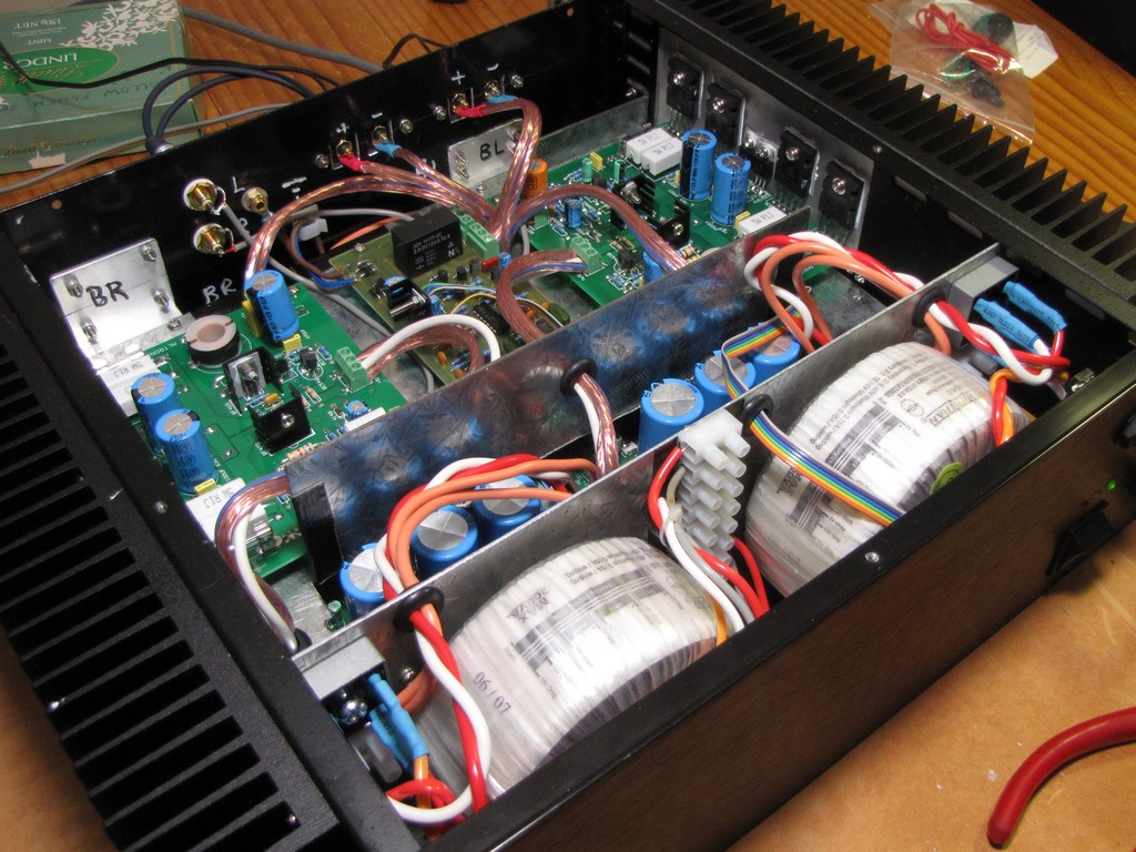

Here is a report back. I have installed the 'back to back' diodes - two diodes in parallel a to k from the amplifier ground to the chassis 'star earth'. I am pleased to report that this has not affected the amplifier's excellent performance - hum and noise are still in-audible.
I (now) understand that these diodes provide electrical safety in the case of:
1: A toriodal tx insulation failure between the primary & secondary
2: An internal wiring failure where the dc has come in contact with the 240VAC - unlikely, 'cause I've tied 'em done real good.
3: An external wiring fault where 240VAC has come in contact with either the speaker cabling or input cabling
In all of these cases the diodes will conduct allowing a fuse, circuit breaker or in my case earth leakage circuit breaker to open, while stopping any current at below 0.6V.
I have also attached a photo of the finished amplifier for anyone else building one. As you can see, the whole stereo amp was fit into a 3RU, the arrangement kept the centre of gravity for the unit close too the front, in order to be nice to the case & my rack, and, as mentioned above, there was no compromise with regards to induced hum or noise.
Thankyou to all thread respondants for your positive encouragement.
