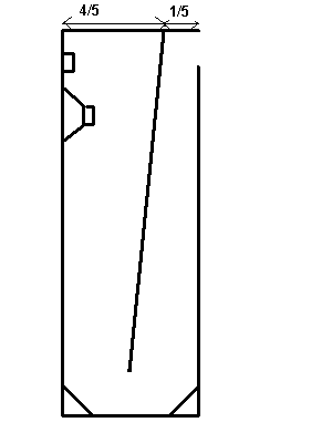

Actually, I know the design I want. Not the dimentions :)
I want to build a tapared ( 4:1) transmission line, folded once
Do you see how the Thor are made? My project looks the same, but with only 1 midbass driver (+ 1 tweeter), other dimentions, and a 4:1 taper
and with an image:
The dimensions will fall right into place, then. Enter a "4" in the SL "Area of the large end" Sd parameter, then a "1" in the SO "small end" Sd parameter.
After that, simply adjust pipe length, driver position, port radius and stuffing parameters until you see the desired tuning in the first graph and desired ripple in the response graph.
I'm assuming you're using the ML TQWT mathcad worksheet.
Bob Brines' website actually walks you through the mathcad worksheets, with full explanations and critique. http://geocities.com/rbrines1/
Dave

I'm using the offset speaker worksheet
why should I use the ML TQWT one? If I understood correctly, TQWT are expanding transmission lines, with a port at the end.
My drawing shows a tapered TL

All the worksheets are actually the same but with the input area set up a bit different. The ML-TQWT sheet has the set-up that would be most convienient to simulate the line you are proposing.

To add a bit, "expanding" and "tapered" depends on the Sd parameters you enter. If you want an expanding-QWT, then your closed end to open end ratio will be less than 1; whereas, if you want a tapered-QWT, your closed end to open end ratio will be greater than 1. Yours would be 4:1.
The T/S specs you entered in the top part of the worksheet include the Sd (surface area) of the driver, so the number you enter in the SO and SL fields are multiplications of the area of your driver.
Dave
**Edit** I should note that I'm using the term "tapered" and "expanding" to describe the shape of the pipe as it moves away from the driver. I think I'm using "tapered" backwards from the common use of the term.
