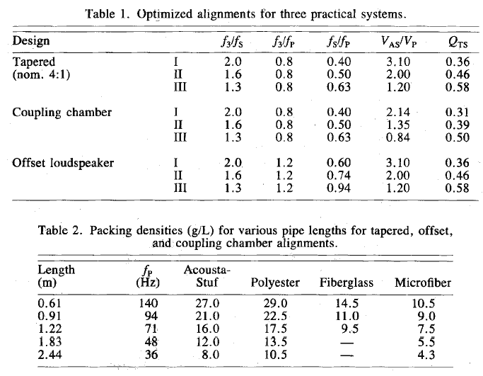

Bricolo said:Using the values from Table 2 (extended)..."
where's this table 2?
Augspurger has presented his paper 3 times, each in a slightly revised format. His original presentation at the 107 AES which i was present at, a 3 part Speaker Builder article, and then a revised paper in the AES Journal. The last is the one that i feel is most complete, but it doesn't have an "extended" table so i suspect the tables have been combined into the one below.
Note that the tables are quite sketchy with few data points and only show a small part of quarter-wave space. IMO Augspurger's work should be seen as background to help you wring the most out of Martin's software.
dave

this is the optimized table
a second one exists, called extended table

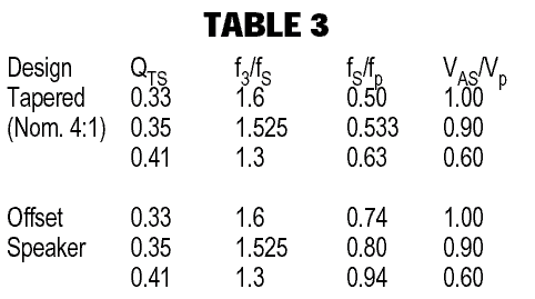

I think it's the one in page 3 of joe's thor review (do you still have it?)
Bricolo said:joe's thor article
this article has a subset of the referenced table and it seems to cover lower Q drivers.
These tables still provide little detail for a line.
dave

I just posted the same
The Audax HM170G0 I plan to use has a 0.35Qts; so I don't bother the few data points, since the driver I want is exactly on a data point
You say the table provides little data for a line, where can I find more data?
I mean fixed values; like augspurger's ones. Not like MJK's worksheets you use to "fine tune" a design based on augspurger's work (I plan to go this way)

There is little data in between. Using Augspurger's tables will no doubt get you closer than a classic approach.
dave

You put words in my mouth. I said it will probably give you a better design than a classoc approach, but not as good a line as one optimized in Martin's software.
Augspurger's table 1st limits you to a quarterwave subspace by limiting you to 3 preconfigured line "formats". Then using a sparse set of data points it gives you lines in a 3-dimensional space. Martin's software allows you continuous change thruout the whole of quarterwave space (ie what if the line worked better at a 6:1 taper, with an oddset, and a mass-loaded port?)
dave

Dave, I think you can explain me:
In Augspourger's tables, what does the Qts mean? Is this the Qts of your driver, or the pipe's one?
some things made me thinks it's the TL's Qtsplanet10 said:the Qts of your driver
dave
cf pages 8&9 from augspurger's paper
