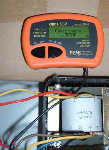

Hello kenpeter,
hello forum
there is a cap from anode to ground.
You can not see it, because it is not shown in the schematic.
But I am sorry you can not ignore it, even if you try.
The constant current source and the output transformer adds
a capacitor from anode to ground. In an audio transformer
you have stray capacitance between primary and secondary.
This generates an undefined impedance from primary to secondary.
A "floating ultrapath" is something people are dreaming of ...
Kind regards,
Darius
BTW: Please don't call a "floating ultrapath" a "parafeed"
thanks.
hello forum
Kind regards,
Darius
thanks.

kenpeter said:Connected across all taps? Or with free ends flying?
I can do the same with an Edcor, here in just a sec.
See #14
connected across primary and secondary of course.
2480pF. all primaries vs all secondaries. Edcor CXPP10-MS-5K
No idea what KHz of the test? Used a Beckman Wavetek 27XT.
And exactly the same when measured from just one end of
the primary (other leads flying) to any tap of the secondary.
And about 80pf from either primary or secondary to an end
bell screw.
bell screw.
