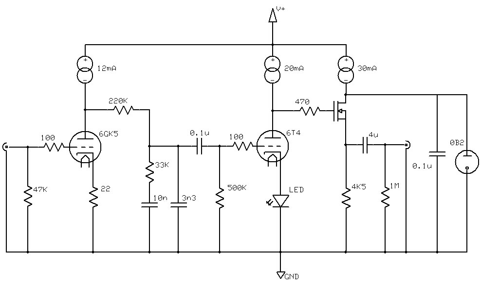

Here's a first go incorporating some of the ideas from the thread. I don't know what mosfet to use, or how to calculate the resistor under it, so that's the next thing to figure out. B+ probably will be ~120V or so, though as low as ~90V should be fine.
Thoughts?

Use one with a lowish Cdg.
To figure the resistor, assume that the source voltage will be within a volt of two of the gate voltage. The gate voltage will be equal to the plate voltage of the 6T4. So the resistor will be that voltage divided by the desired operating current.

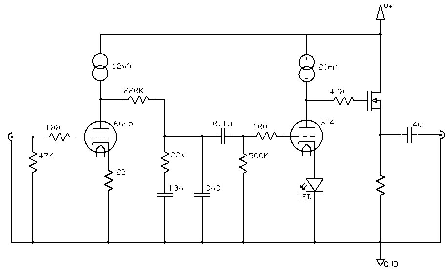

Assuming you get close to full mu gain from the CCS loads, you come up (IMO) a bit short in the net gain dept., using the 6T4 in the 2nd gain position. Expect somewhat less than 40 dB. net, in the real world.
The IRFBC20 I previously mentioned will be fine in the source follower role. A FET with a low and stable reverse transfer capacitance is required. Check the IRFBC20 data sheet out.
Eli Duttman said:Assuming you get close to full mu gain from the CCS loads, you come up (IMO) a bit short in the net gain dept., using the 6T4 in the 2nd gain position. Expect somewhat less than 40 dB. net, in the real world.
Input sensitivity on my power amps is about 1.5V, and I never listen anywhere near that level. So, I think I should be fine. But, the 6Gk5 and 6t4 have the same pin out, so I can just dial back the current in the second tube and drop in a 6GK5 if necessary.
Here's a slightly more complete schematic.
