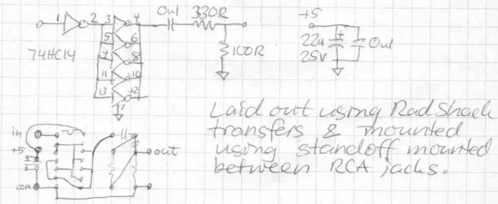

Here's a scan of a portion of my notes that shows the schematic and board layout. I think I used the HC14 just because it was handy.

Hi Dangus,
Thanks! I can see u are using HC14, what's the different between it & the HC04?

The 14 is a Schmitt trigger type, probably the best choice but the 04 should work fine.

My written notes mention the pin 59 enable thing, but don't say anything about having to do anything about it. Since the board was laid out for a Toslink output they may have just hard-wired pin 59 to be pulled-up all the time.
I took power and common from the holes for an unpopulated bypass capacitor C205, and used one hole of JA8 (the unpopulated Toslink transmitter) for the signal. I'll see if I can get the player out and have a look inside tonight.

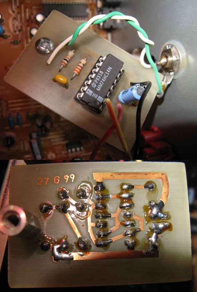

I pulled the unit out last night and looked inside. The trace from pin 59 wanders off with a bunch of parallel traces which aren't easy to follow; maybe I just measured to see if it was enabled, or figured I'd just hook up the output board and worry about it later if the output didn't work.
Here's views of the top and bottom of the board. It's mounted to the back panel with a single hex standoff. The audio board on this LDP is conveniently a separate board on the side, so the solder side was easily accessible.

Hi guys,
Thanks for all your time & guidance, I finally got it right.
I did what Dangus recommended, tied up the other 2 unused inverters into the circuit & at the same time I found the GND to my 74HC04 was not properly soldered.
