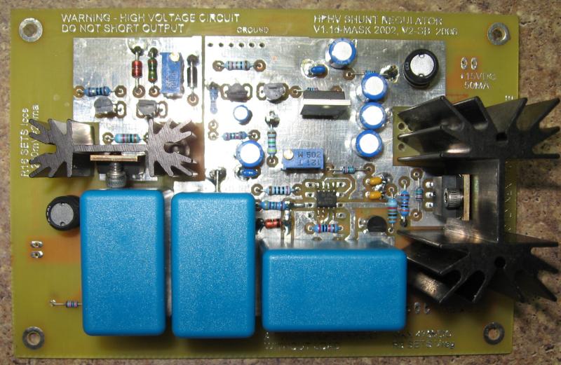

This project had been on the back burner for some time. It is a very sophisticated High Voltage Shunt regulator PCB. I think it is an original Allen Wright's design. It can be use with an external power tube or as stand-alone. I made my own PCB using his schematic and parts list. I found the original documentation on the net, but it seems to be gone now. It took me some time to collect all the parts but I found them.
Been on the road again, I found some time to complete the PCB.
I'm planning to use it into my upcoming EAR824P Phono preamp clone.
I have two complete PCB completed. Just need to test it now.
Since it is not my design, and it is a brand new project I cannot answer any question on this circuit. I need to work on it first.

This is the top view.

Hi Alga_emi
The original manual says
DUE TO THE SPECIAL (DUAL) POWER PINS/CONNECTIONS OF THE OPA655P, DO NOT SUBSITITUTE THIS DEVICE WITH ANOTHER OPAMP.
Did you adjust the design for opa656u as in your BOM? I wanted to build this shunt regular for the longest time but had no chance to locate the ops655p.
Thanks!!
In my latest builds of the HPHV I used AD9631 instead of OPA655. These are high-performance op-amps with standard single power connections, and - more crucially - there is no facility for external compensatin or offset nulling, so pins 1 and 8 are not connected internally. I haven't tested my regulators with an oscilloscope, so I can't rule out ultrasonic problems, but they appear to be working fine.
Alex

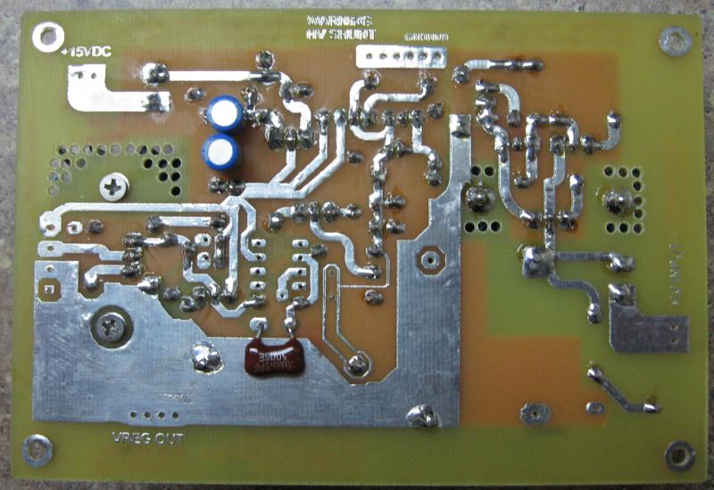

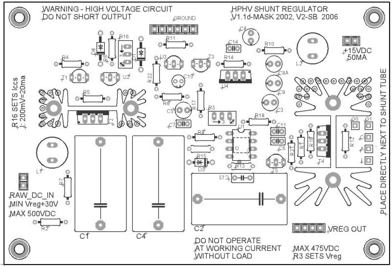

Algar_emi said:
pchw, my PCB design was adapted to accept the OPA656 that has only pin4 and pin7 as supply voltage pins. After verification, it would also accept the AD9631. Check the PCB layout zoom for more details.
