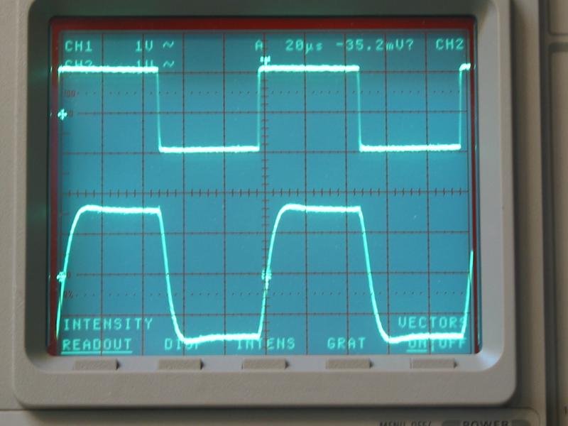

I'm using a 25VA Amveco mains toroid in a test amp. I used
that one because it was the largest one I had and I thought the
primary inductance would be better than the 15VA ones.
I'm using it in a parafeed circuit very similar to Diego's, using a
MOSFET as an anode load with active complementary current drive
First description I know of is at:
http://www.diyaudio.com/forums/showthread.php?postid=638005#post638005
Anyway, the transformer's performance as a parafeed audio output
is excellent. It has no finite inductance effect down to the Fc of 8Hz
set by my parafeed cap, and the upper Fc is about 40 KHz (-3db).
Attached is a scope photo of a 10KHz square wave.
These results are using the primary at 2K ohms impedance.
I don't know what happens if you go up to higher impedance but
I guess it may affect the HF performance somewhat.
The sound is fine. I haven't done a direct comparison but this amp
sounds like a good SET. It's nice and detailed, seems to have great
frequency range, and I don't think the transformer is negatively
affecting the sound, i.e. it's doing what a transformer should do.
I would not hesitate to use these in an inexpensive project to
check it out for yourself. If they saturate at 25VA at 60 Hz, they
should be good for a few watts down to 20 or 30 Hz. I think there
is a lot more info on this on other threads here as cited.
Michael

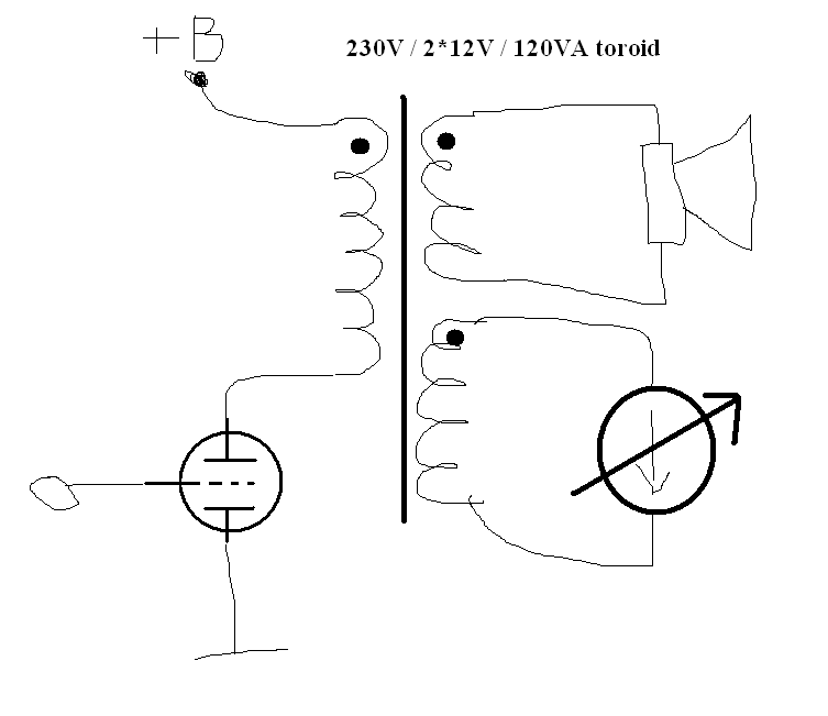

I came accross this old idea using DC bias curent at the secondary to compensate magnetic field from primary DC current. Looks good and simple on paper. Can make it adjustable if you like to try different levels of magnetisation of the core.
Anyone tried it in practise?

2mA tolerance comes to +/-5% which can be hard to maintain during long periods if considering tube ageing? Or can we assume tube bias current will allways stay within +/-5%?
Maybe can use a correction circuit for setting the toroid secondary DC bias. The gain in the DC feedforward path is the same as toroid winding ratio. This should maintain correct compensation current in the secondary regardless of tube bias current changes. Can even tune the tube bias if you wish to try how it affects the sound and at the same time keep the toroid in it's optimum performance. I'm sure this idea is not new even I don't recall seeing it before.
- Elias

Yesterday I looked into my toroidal stock and found some 230V to 24V + 24V units. I thought about using one for output transformer for a 6C33C operated at about 250mA. Soon I concluded that I would need to inject about 2,5A in the 24V winding. I measured the DC resistance of the 24V winding which should be about 0.3R...injecting 2,5A would develop 1V, which is not much, but then, how to accomplish a fine control over the 2,5A? I thought about using an LM338 set as CCS for the job, but there would be at least a 4V drop over it and the current setting resistor...that is 10W dissipation. Hmmm...better would be to use a trafo with 2 110V windings, one for the output tube and the other for DC cancellation...but the 230V winding is much more appealing, as it will present larger inductance.
Maybe a toroidal with dual 18V secondaries. This one would need about 3.2A in the secondary to cancel 250mA in the primary. One could then feed the 6C33C with 12VDC/3.3A, put one of the 18V secondary in line with the cathode and set the 6C33C bias for best cancellation.
just some thoughts...
Erik

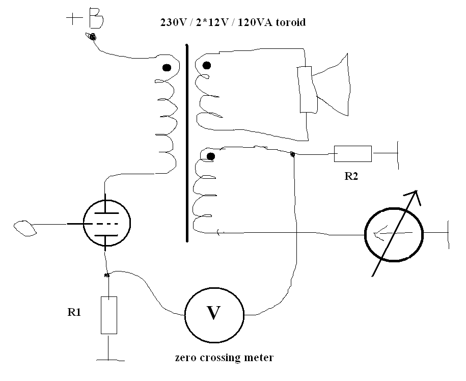

I would like to have a toroid with for example 230V / 12V + 110V windings. Could reduce the compensation current quite a bit.
316a:
I see no problem putting a feedforward DC feed. Basically all you need for it is one opamp and one power transistor for current generator + some small signal stuff. The price for these parts almost nothing.
Why do you need the choke for? If you put one secondary winding in series with filaments, and drive it with constant current, there is no need for the choke. By definition constant current source will keep the filament in constant potential also. There is no way the signal can be fed back to filaments.
Well, buying a ready made output transformer kills the DIY in it :D
For the passive DC current tracking, can use simple metering circuit. The ratio of R1 and R2 is the same as toroid winding ratio.
I think I need to put the meter in the front panel of the amp, because otherwise it makes me worried if the bias is correct and it prevents me from enjoying the music :D
- Elias
