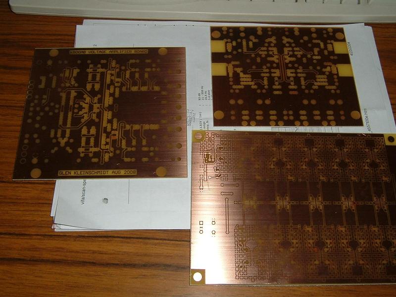

Dayjob duties and troubles are still keeping me away from updating my website with the latest power amp I designed and implemented. I really hope I'll be able to replace the current teaser with construction details, measurements, etc... pretty much following the same pattern and layout as I did for the PGP amp, ASAP. This project will follow the same roadmap, final bench testing is now completed, now the power supply, auxiliarry circuitry, case, then audition tests.

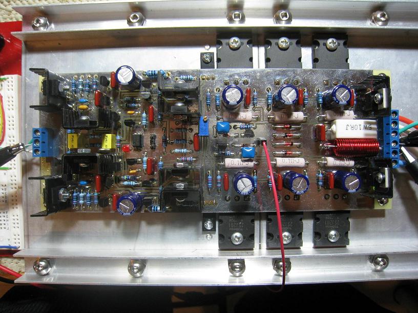

Meantime, here are the schematics and some final experimental results. I should probably start from my dissatisfactions with the PGP amp. Being a software guy, I like modular things, pretty much like LEGO building blocks that can be assemblied and tuned to match certain requirements or tastes; unfortunately, this was not the case with the PGP amp. The HEC output stage was anything but flexible and the requirements for precision resistors and on board tuning is really annoying. I've seen recently on this forum a DIYer fighting the HEC battle, it's very hard to distinguish between an out of balance HEC stage and some external issues, like power lines induced 2nd harmonics. The front end that Edmond designed and simulated is again not a model of flexibility; changing the gain from 28 to 20 requires quite a bunch of parts to be replaced, because all the Cherry feedback loops have to be rebalanced. OTOH, if one decides to build his own PCBs and change the layout of the whole amp, chances are high the final results are going to be poor (I had such a DIYer case that I was trying earlier this year to help by email). And of course, complexity and costs are issues as well; the front end PCB is definitely something that should go to a PCB manufacturer (I use either www.4pcb.com in the US or www.apcircuits.com in Canada) which is known as being quite expensive.
I have decided for a current feedback, unity gain OPS able to drive (this time) enough current to safely support 4ohm loads; theree pairs of 2SK1530/2SJ201 were used. The output devices are driven by a diamond buffer, while the VAS is a so-called Hawksford cascode. Current feedback is applied to the input stage, set for a gain of 1. The input stage is thermally compensated.
The protection is quite original and is experimentally proven to be very efficient. The output devices current is monitored by a standard current sense circuit. However, this circuit controls a floating current switch. The loop gain is pretty high, so as soon as the current sense circuit injects a small current the curent switch fires and latches, effectively cutting the VAS and the diamond buffer currents. The proces is sequenced, to avoid any transient effects at the output which should drop cleanly to zero. I have successfully tested several times for load shorts at full power and the amp survived. An optocoupler (no need for a high speed device) is used only for signalling the fault condition.
With all due respect to Edmond and others here, I was unable to identify any advantage of a TMC compensation schema over TPC. The OPS uses TPC and, combined with a very careful layout, delivers 8MHz of unity gain bandwidth and 85 degrees of phase margin, good enough for pole separation when adding a whatever front end stage (with gain). Distortion @20KHz is a mere 0.002% (20ppm) and IMD in the same range.

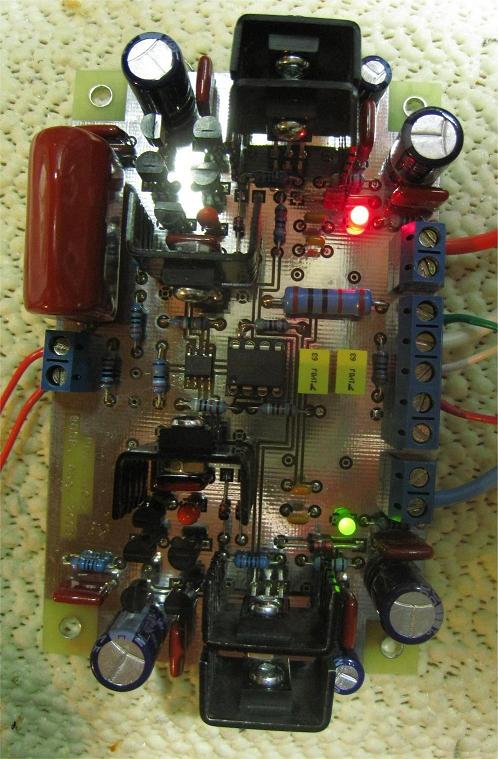

The front end was so far build in three versions.
1. A National LME49810 IC, using the bias terminals as outputs (they deliver a little over 2mA just good for biasing the OPS input stage). This is a ridiculously simple solution, though delivers excellent performance. The overall measured THD20 with the standard LME49810 compensation was very close to the National datasheet (for the LME49810 alone) of 7ppm. The only think not really spectacular was the slew rate, limited by the LME49810 to about 40V/us. The IMD consequently measured slightly higher (at around 15ppm, this has to be doublechecked). I believe this approach is very effective and I would recommend to anybody that is looking for a quick win rather the ultimate performance. BTW, the on chip Baker clamp works great.
2. A mixed (IC plus discretes) current feedback front end (schematic is attached). The IC is an ADA4899-1, one of the best bipolar ICs available today, coming from Scott's playground 😀 Another Hawksford cascode as a gain stage and a servo loop around a good FET input opamp. Compensation is very simple and the unity gain can be set anywhere between 1 and 3MHz. Some implementation details are missing from this schematic; two very simple power supplies are added for the front end supply lines, so that the front end Baker clamp would kick in before the OPS enters in clipping.
End to end measured performances are quite spectucular. Depending on the front end compensation schema, THD20 goes from under 1ppm to 4-5ppm. There is of course a trade between the stability margin and loop gain. For 1ppm and under the response was sligtly overshooting (<15%). To stay safe, the final circuit deliveres 2ppm of THD20 and the same amount of IMD19+20. Slew rate is around 270V/uS (non slewing, of course) at full output, before the Zoebel and output inductor. The output inductor is not required, but I've decided to settle for a 0.6uH || 4.7ohm to stay on the safe side. The amp is stable in whatewe reactive load I was able to provide.
http://www.synaesthesia.ca/files/FS.gif
3. A pure discrete front end, using a current feedback input stage and a folded cascode gain stage. Schematic to be published later, but performance wise there's nothing to write home about. It was actually worse than 1. This doesn't mean anything but the circuit needs more design work.
Just for the heck, I have tried the new OPS with the PGP front end. Unfortunately it is not stable out of the box and I was not in the mood to start tweaking neither of the boards.
Again, I'll update my website as soon as possible with all the design, construction details and measurements results. Meantime, comments are welcomed.

Impressive! I like your current switch protection. It reminds me of a device I used a very long time ago, something like a dual gate thyristor I think. Must look it up.
Again, impressive piece of work.

Very impressive, Ovidiu. You have been very busy.
I like the use of CFB, a more sensible and versatile implementation of local NFB around the output stage than the PGP, and of course the THD figures are excellent.
I also really like your natty protection circuit. It first reminded me of a triac, and then I started musing about the concept of the "audiophile triac", it being implemented in discrete form (for "real men") 🙂
I like to count signal path transistors. My eyes are getting old but, excluding power FETs, I reckon the PGP has about 40 and the YAP about 20 plus op-amp. So I think you are reducing the complexity a little, which is a good thing.
Brian

I have been busy etching this evening. Final iteration of the K800AB low current rail regulator and voltage amplifier boards for one channel ready for drilling and loading (the big board on the lower right is a different thingy though).
You really ought to buy a UV light box, demel drill and a cheapo etch tank – save a fortune in PCB manufacturing costs.
