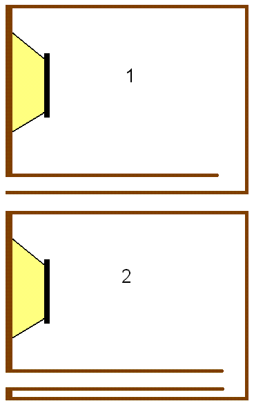

A quick question on the sub too since I'd like to start cutting wood today for it. Can the port be done as per image 1 (where the bottom part of the enclosure forms one side of the slot port) or must it be done as per image 2 with two free edges?

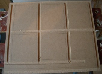

I had already worked out my box dimensions in WIN ISD however, just wanted to check that port would be ok. Here's todays progress, I expect you can see where its going ;) . Only 12mm MDF but you can see that quite extensive bracing will be used along with a double thickness (possibly MDF and Ply) baffle. Have to make another just like this tomorrow though. Oh well, at least it's only 1 sub :D

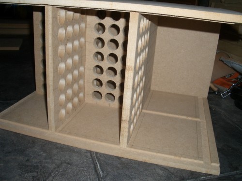

Just as a bit of an update :) . The photo shows a trial assembly, both "side" panels have the routed grooves into which the bracing, inner baffle, port and outer panels fit; so these parts are just slotted together for this test.
I still need to drill more holes :eek: :xeye: , but once thats done I'll add up the actual volume and cut the port to the correct length. I know the volume is less than I wanted (didn't exclude port volume :eek: ) so I'll need to make the port narrower, probably in the sides so it won't reach the edges of the box. Sill achieves a -3db point at 39hz so not too bad for its compact size, the hump isn't too drastic either :)

Started glueing on the sub box today, will update with pics tomorrow. Shouldn't take too much longer I hope, waiting for the driver at the moment though. Those braces ended up with a total of 136 holes :eek: , glad thats done :D
Said I'd update you so here we go:
Just got to sort out the double thick baffle and the brace that sits behind it :)
The port has been divided into 2 smaller ones. This looked like the best solution to adjusting the port size down as it adds physical bracing and apparently halves the port turbulence (perhaps its the value for each?).
