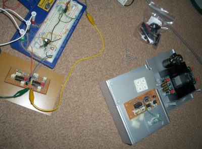

Have got my amplifiers now though. I'm trying to fit them into a rather small case (which looks nice) but may be too much of a challenge to get them in there with power supply and crossovers. Plan is to have main capacitors in the gap between the heatsinks and crossovers will occupy just about any last nook of space, possibly on the roof of the enclosure, above the heatsinks. Would be nice to use SMD but can't really do so . You can see it next to an existing though unfotunately broken 2 channel 2030 chip based amp, the case is the same. I have mounted the amplifier PCBs more compactly as you may be able to see, they are vertical.

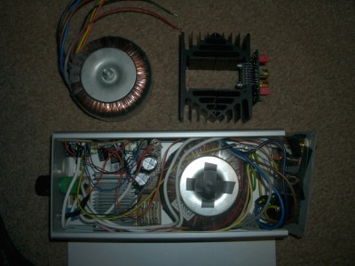

Bad news is theres no chance of finishing this today so I'll need to use headphones for a while . I have made some progress with the amplifier unit, though the transformer I've decided will be seperate. The crossovers are nearly done now so I just have to make the power supply board and mount everything in the case. Then I will need my satellites o ) and said transformer box.
