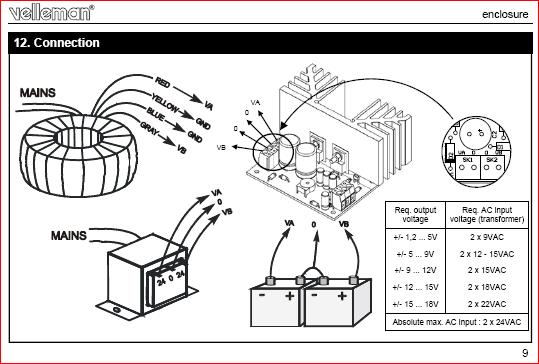

If we look into the Manual
http://www.allspectrum.com/velleman/K8042/illustrated_assembly_manual_k8042.pdf
you see in point #9.
that this kit uses LM317 and LM337
So if you order Velleman kit, you in fact is using same way as suggested in this topic.
The difference is only that you get all that is needed in one package!
And you also get some good instructions how to set the +- dual 12 Volt.
For higher currents they say you may order a heatsink, too.
I do not know how much current you need.
I say you need not heatsink to order.
If you like, you can take some pieces of aluminum plate and put these onto those LM317 and LM337 3 pins IC.
Order that Velleman kit.
It looks very alright for your need.
However, you need to buy 1 transformer.
To power this kit.
See my attachment from the Manual.
And you may want to put it all into some box. If not in the other box you have.
That is all.
Kit + Trafo ... and you have it done.

I know I have to get a 2x15VDC transformer, but I wanted to know if I could swap out the LM317 and 377 and replace them with the 7812 and 7912 if they are better than the regulators that come with the Velleman kit.

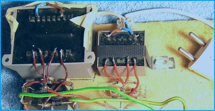

I wasn't planning on it actually. I looked at some of the chassis mount transformers, but they're all MUCH higher current than I need. I was thinking that I'd hot glue the one I ordered in place inside the box that I'll be using for the transformer and the preamp, and then solder the connections to the preamp board and to the chassis mounted AC input jack.
Something like this way of mine, maybe.
It is from one small Class A Power amp (my own design)
with separate Trafo+Regulator for input/voltage amp
and Unregulated Bigger transformer for Power Output stage.
The bigger is glued to the bottom of the board.
The one to the right is using mechanical attachment
I did fix smaller trafo using plastic package strips and 2 screws.
As shown.

Hope this attachment works.
side power one side of your rectifier assembly by pin 7 the other
side of the bridge by pin 12. Tie 9 and 10 together and make
and use this as your ground ref. Instead of the wire coming
off the middle leg of the secondary on the attachment your
jumper between pin 9 and pin 10 form that middle leg.
