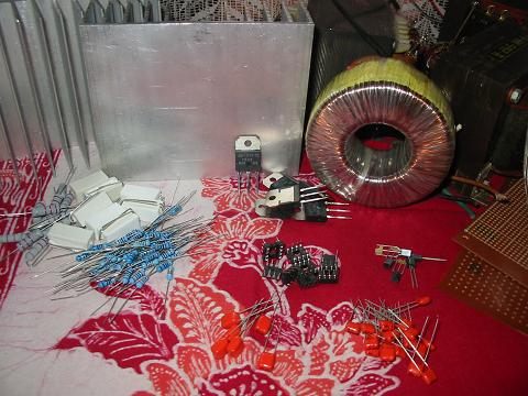

Hi Ionomolo,
The idea to build this class A is coming since i already have pair of LM4562 in hand and wait for a good idea,
I just find all parts, and being noticed from a friend that class A amp is not for beginners.

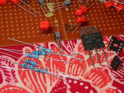

what kind of PSU i will need for stereo ?
if TIP 142 is too late for LM4562, is LM833 or TL072 will suitable?
well... how hard it will be?

I was going to pm you to warn about some of the issues regarding class-A amps as i've noticed that your aren't among the oldest-registered members.
Well, the true begginers where those who built the first amps, they had nobody to ask! And they did build class A amps because they are the conceptually-easier.
About the opamp, i suggest to try with the TL072 and then replace it with the LM4562 once you know it won't explode. The output transistors aren't the best you can find, but they will do the job.
There are only four things you must know before buliding it:
The transformer must be able to supply continuous > 3 A for mono and > 6 A for stereo.
The heatsinks should be very big. Running the amp without heatsinks will immediately destroy output transistors and loudspeakers.
You cannot feed it higher than rated voltage. I suggest you to start with anything arround 12-14 Vdc and a single ccs (you will notice that there are two identical sub-circuits connected to the speaker output. Start building it with a single one). This will allow for 6-8W of output power, will require a much less expensive supply (1.5/2A will do) and will let you know if you want to invest in the big heatsinks and transformers requiered for maximum output.
I suggest you to post or send me by pm a picture of the transformers and heatsinks you plan to use.
The amp does not have an incredible amount of parts so it should be an easy build (it took 30 minutes for me to do a mono one with all parts over the bench).
The amp is not very powerful so you need to use efficient speakers and not listen to outrageous levels.

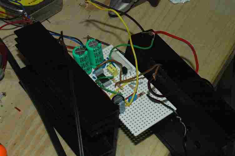

At the moment i'm trying to design a faster output stage (either bjt ccs-loaded sziklai or mosfet ccs-loaded sziklai) but this will be a hell to get stable, the "slowness" of the output transistors plays for your part if you are new to this since it will not requiere the extreme care with layout that faster parts need.
I belive you will like it because it's a very "politically correct" amp. Nothing prominent, warm, a bit of "tubey midrange" and low distortion, which means it's not adding so much of its own to make anything not liking its character hate it.
The picture attached is from the first prototype i did (6W powered from +/- 12V with a single ccs.). I belive you shouldn't have any problems building it.
Somebody has done anything releated to ccs-loaded sziklai (replacing the usual 100R with a ccs arround a couple of mA's) *?

Sorry, i've just noticed i forgot to attach the picture.

Dear Ionomolo,
i'll start with a single ccs,
maybe a bit slow development, theres some thing i need to learn first, than bother you with some newbie questions.
Here attached are the parts.
i got some of shown heatsink. may will consider to invest toroidal transformer and better parts for upgrading later.
the shown toroidals are only 15-0-15 20VA and 15-0-15 2A which only enough for buffer power. 2 x 5A 12-0-12 E1, a lot of resistors with vary watt. all the cheapest.
The 12 - 14vdc maybe a problem since 9 or 10vac /min 3A transformer is rarely found here. is it bad to have a different power for the opam? ( regulated ) so that we able to have about 16VDC for TRs from other bigger power.
what is U3A?
have you try MJ5003? can it be other option? ( i dont know what you guys call for TR with that UFO lump, we call 'em jengkol ).
i have OCL amp using that UFO 5003/5004, they resist to higher heat and voltage than 2955/3055, higher the bias and lower the voltage was make the sound nicer. that a bit same tech with this class A don't you think.
Brgds.
Eka

I'm not a fan of toroidal transformers because they have wider bandwith and let all the garbage from the ac line to get into the amplifier. Mine has two blocks, one containing the psu and the other containing the amplifiers, so emf is not much of an issue.
The 0.5R resistor should be at least 3W! a 1/4 one will burn immediately after power-on.
The 12V-0-12V transformer is ok (a bit on the high-voltage side). assuming 0.7V drop on the diodes it will give 16V.
The transistors should have a beta of at least 300. I belive that the ones suggested in Douglas Shelf book would do a great job here.
The power of the opamp may be the same of the output stage or a bit lower. The reason for choosing lower voltage is that the opamp would not be able to drive the output transistor into hard clipping and this will prevent massive carrier storage at the base (*).
I belive that the heatsink is a bit on the small size for that voltage (assuming you heatsink each TIP142 transistor on a different heatsink, if you plan to place both on the same heatsink it is definitely insufficient). The "other" transistor in the CCS (i belive it is a bc5xx in my current ones) should be placed as far as possible (without creating too long wires) from the big heatsinks (it is in the center of the board in my current prototype). because if it's close to the heatsinks it will thermally track the output stage temperature and make the current go lower than expected (One problem with push-pull amps is that they do the opposite, go higher currents when they heat, and this is dangerous).
Conclusion:
( a ) 12-0-12 5A transformer is fine.
( b ) Heatsinks are bit small.
( c ) 0.5R needs to be rated at least 3W
( d ) EXTRA: Place decoupling transistors close to the power pin they are decoupling (that applies to all amplifiers either class A, B, C, D and to all other circuits that aren't amplifiers).
( e ) If you wire it properly it should just work like any other amplifier.
