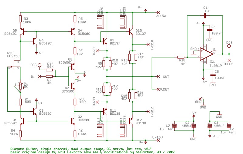

I've been toying around with a folded cascode amp, inspired by AD829, AD797 and LT1469. The aim is as usual portable use. I've come up with this simplified circuit. It simulates very well, seems robust (changing resistor values doesn't affect it that much), swings to within 1 V from rails, simulates well down to 3 V supply. R22/23 and R24 could be pots for trimming DC-offset and bias. 100 Ohms and 47 uF in series with the input simulates my iRiver IHP120.
Please comment.
The three front end currents seem very low.
Is this to suit battery power?
You would probably be better using a FET input opamp for the front end if battery life is a concern.
How low can you take the output stage bias currents and still retain good crossover distortion suppression?
The 6p nested feedback cap looks unusual (can't read the number).
What about leaving alternative pads/traces/routes for other compensation strategies?
What Vbe is being predicted for the two folded cascodes?
Battery life is a concern, but not a major one. A cople of mA's more or less doesn't matter. What simulations should I run to find "proper" currents to the front stages? Increasing the currents doesn't alter the square wave response, phase response, voltage swing or distortion.
I don't really know how to detect crossover distortion but with a 30 Ohm load and 2.2 V output, I can see a slightly broken sine wave when the bias on the output transistors is 650 uA. With a 300 Ohm load, I can see no crossover distortion at any level. Please help me to learn how to measure or detect crossover distortion with LTSpice!
I'm just not clever enough to predict Vbe. I only know how to simulate. I usually try with different resistors, LED's, voltage supply etc to see to that there are some margins.

You might try replacing the Widlar current mirror with a Wilson mirror.

The red LED should have between 1.5 & 1.7V across it when lit.
You have only 0.3mA passing and I suspect this reduces the LED voltage and places it on a steep part of the IvsV curve.
What voltage is dropped across the LTP collector (load) resistors. I can't tell if they are 220r or 820r.

The drop should be almost exactly 1 V. The resistors are 820 Ohm.
The current through the LED is 0.86 mA. Sorry about the crappy picture quality.

820r and half of 1.25mA gives 513mV.
Subtract this from LED volt of 1.6V and Vbe~=1V.
That is far too high.
The sim won't work properly.
But, if the LED drops only 513mV+600mV~=1100mV then the LTP works. But the LED @ 1100mV is seriously underbiased and will change voltage with the slightest changes in temperature and/or current and/or supply voltage.
You have to get the circuit working properly first before you think about analysing it's behaviour/performance.

I think I see what you mean. Can I just use a zener diode instead? What value would you recommend? I've read that a large voltage drop reduces noise but you lose some voltage swing, and voltage swing is more important when powered by batteries.
One alternative is to accept class AB and use 2 x 9 V batteries instead of 8 AAA cells.
I would also be happy if someone could recommend me "proper" currents to the front stages. After some reading, I understand that folded cascodes do better with some extra current. Since it's only driving the diamond buffer output stage, not the output transistors directly, do I really need more current? The problem is nothing "looks" better when simulating the circuit.
hi,
increase the voltage drop across the load resistors.
You can increase the resistor values and/or increase the LTP current.
FETs, I've heard, suit high current so how about asking others' advice about this solution.
Try increasing the LED current to 1mA and increase the Cascode current to around 1mA as well.
See how that stacks up with voltages around the circuit.
