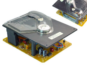

Does anyone know something about cdm4? i can´t find the doc in the net, is it DSA compatible? How to send commands to it? It´s really cheap (7€) and for experiments i consider it better than using my CD PRO2 because of damage risk. What kind of connectors are on this unit?

Hi Till, the picture is of a CDM2 if I'm correct. Can't answer your questons but can you obtain CDM4's ? If so I would be very happy to buy some ( 5 or 10 when possible ) because they are obsolete for years here. They are IMO one of the best transports ever made. They play CDR too ! I will send you a private mail about this, OK ?

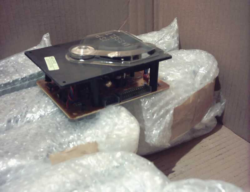

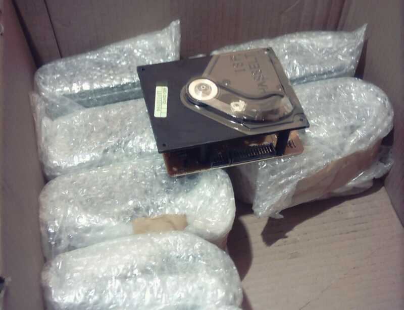

I recived some of these CDM4/31.
The units seem to be unused, there is a plastic shield on the top to protect the laser. I can´t test it right now because i don´t know what kind of connector is on the PCB and what commands to control the CDP are needed.
There is one sign CDM4/31
3104 108 76231
8920 AH E-43611
There is one 5 Pin and one 14 Pin Connector on the PCB.
I see a 20 Pin TDA5709, 8Pin 4560D JRC 1347J, one TCA 0372DP2, one 28Pin TDA 5708, and some Transdistors and passive devices.

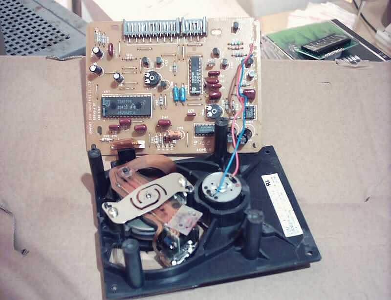

How does a code number look like?
like 510 11001 or 504 11002 ?
I opened one to make a better pic:
ask if i should post more numbers or read something not visible on the pic (cheap camera)

Till,
On the PCB is just the laser and radial control and some opamps to drive the transport. To get things working you need to decode the data (SAA7210/7310 decoder) and a microprocessor which reads the decoders subcode output and drives the radial control again. (doing this at work, so from memory).
In short, you need a philips cd player.... So it is not complete transport like your cd pro2 (which should have the decoder and micro, i2s out).
And i would also be interested in buying one or two of those..
See hasselt on the drive, the factory has just been closed....

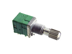

The price was 7€ without any shipping cost etc. But i have only 8 ordered, 5 are promised to jean-paul. At least 2 i want for myself and the dealer (Pollin) has at the moment only 3 left. They also hav cheap alps rotary encoders(0,45€) or LCD ´s:
