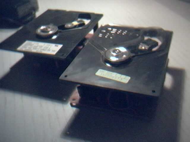

Got the cdm4 today and now i understand the confusion with the cdm2. They look identical!! I have a CDM2/29 (took it out of the cd650 for a moment) and now a CDM4/31. Taking apart the cdm650 transport is 2 torx screws, 5 min job...
From the top they look similar, the laserunit of the cdm4 is a bit smaller. On the inside, the motor for cd rotation is a piece of work in the cdm2 and looks like a standard piece in the cdm4. The connectors on the side look equal and i did a quick comparison: the signals are identical, but i still have my doubts. I think the circuit behind it is different for some signals. I am not (yet) going to try a swap, but maybe if the cdm2 goes..
The signals are looking from the side, pcb at the bottom: I only had a first look, i could have made mistakes!!

Some signals are straight from one of the chips, no problem there. Others, like rd go through some transistors on the cdm4, but it comes straigth from the 5708 on the cdm2. So if they are really exchangeable ????
The cdm2 pcb is a mess, lot of rework (floating components) and the solderjob is crappy (chips are reworked also). The cdm4 looks much better.
My pcb was broken on arrival!! a corner of the pcb was broken off. Not really a problem: two wires and reconnecing one resistor should do the job. No issue for me, i am probaly going to use only the laser for a swap. the cdm4 looks much more like the cdm2 then to the cdm3 (which looks more like a cdm1), strange.
I have the service manual for the cd650, but not for the transport part. I have one for a version of cdm2, but with the decoder microprocessor on board. In the 650, that's on the main pcb.
right one is the cdm4, cover still on the lens.

Mmm,
When i talked to a friend of mine who worked in Hasselt, he told me that it is not possible to exchange because of physical differences with the transports (and therefore differences in the programming of the controlling micro). But looking at the cdm2 and 4, they are very similar. The baseplate is exactly the same and the pins on the connector are too.
So probably this cdm4 is designed to replace the cdm2...?
But remember, a 'normal' cdm4 cannot replace the cmd2 and there are cdm2 versions with a microprocessor on the pcb out there.
But i think now i have a spare transport for my cd650, that's something. The broken pcb is easy to fix: no problem for me.
