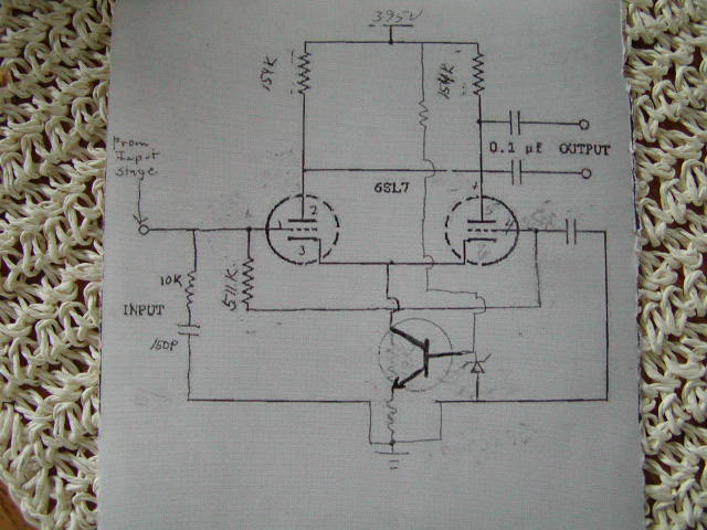

I haven't played with CCS's before so I need some guidance so I can learn. I will try to attach a schematic.

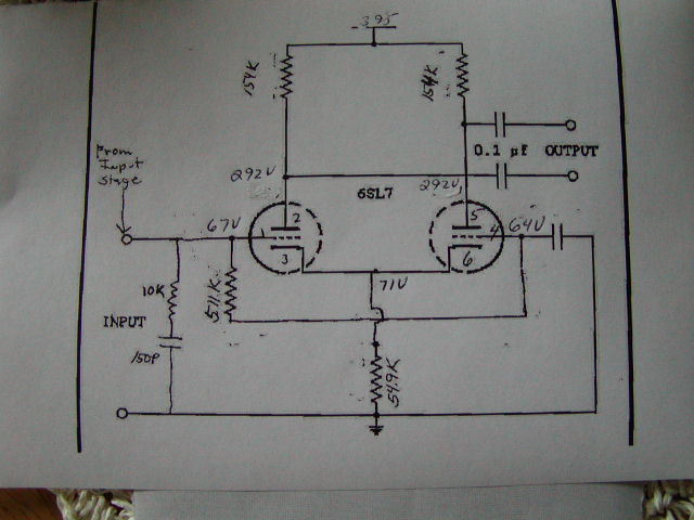

I would like to replace the 54.9K cathode resistor that is being shared by the 6SL7 with something better. I have 71 volts between ground and pins 3 and 6 of the 6sl7. I believe this will result in .0012932mA
Will this primative transistor,zenier and 2 resistor combination work or is there something better out there that will provide better results?

You've got some volts to work with, so that's a good thing. Your scheme will work, but to make it optimal you want the Zener voltage to be fairly large so that the emitter resistor is also large- that increases the source impedance by roughly hfe times Re.
One neat trick is to tap the DC voltage feeding the reference off the plates of the diff amp through symmetrical resistors - that way, common-mode stuff is partially canceled.
I think you mean 1.29mA, not 0.00129mA.
Do you mean the cascode? If so, yes, but you can easily hit diminishing returns. If we take a single NPN with an hfe of 150, and we use a couple of LM329s in series as a reference, the emitter resistor will be about 13k. So the source impedance will be roughly (150)(13k) = 1.9M. Not bad, especially compared to the cathode impedance.
That will certainly work. I have even used really puny constant current sinks like this: http://www.freewebs.com/valvewizard/ccs5.jpg
and it still gives better balance than a 54k resistor!
