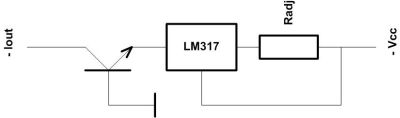

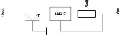

Could this topology work? Does it eliminate the problems discussed above?
The LM317 make adequate cathode CCS's - much will depend on the bypassing.

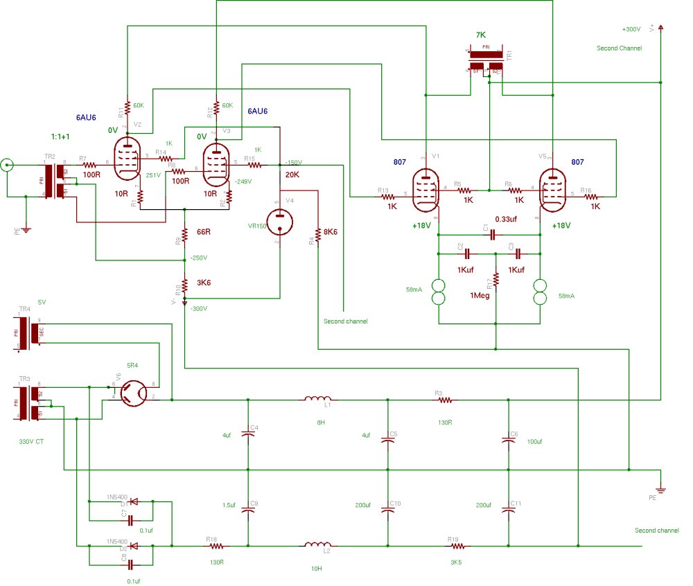

In my latest amp I am having real problems getting a robust enough CCS for the cathode's of my output stage. The driver is direct coupled off of a differential pair which is hung off of a -300V negitive rail. The negative rail is solid state and comes up straight away. The PP output stage has +350V B+ (at 50mA per valve) which is valve rectified and comes up with a time delay.
I have built a MJ340 based cascode CCS but it keeps going pop at the slightest provocation. I need something very rugged to withstand the large voltage on switch on, and the considerable initial current rush.
Can anyone suggest good transistor combination for this demanding role and any other design consierations I should be thinking about.
Shoog
Gary - funny you should say that as its my version of your Tabor.
Please find attached the schematic. Its quite remarkable - at the moment I have the amp in the main system. At least one of the CCS is down but it still plays and sounds very nice at low levels. The really amazing thing is that despite the minimal power supply f9iltering and the gross mismatch in current draw on one side - it still has barely any hum at the outputs. The partial feedback seems to be working miracles.
Speaking on inrush current, there is no such thing through a CCS.
The 807 will try to conduct hard as it comes up. This will ask the CCS to suddenly deal with a high demand for current.
Shoog,
The output stage CCS has only 18V across it, per your schematic. Anything should work OK there.
Suggestions:
1/ Put a timer in the neg supply rail
2/ use MOSFETs rather than Trs in the CCSs
3/ use a CCS in the input stage as well as the output stage - this is a serious sonic limitation IMO.
4/ I see no provision to balance the output stage currents - across two stages with a LOT of DC gain, even having CCSs in the output may mean all sorts of internal struggles...
5/ The output impedance must be *really* high - do your speakers appreciate that?
Regards, Allen
Shoog,
I tried your circuit (also 807, but with different drive). The CCS in the 807 cathodes were LM317, but it got very hot and finally gave up. Then I ended up with grounded cathode and fixed g1 bias - no problem since then. I did not like the bypassing capacitors, either.
My first thought is during startup the 807's are warming up before the 6AU6's. With the local feedback arrangement this will pull the 807's to the B+ rail acting like cathode followers and expose your CCSs' to high voltage. Another possibility is grid cathode arcing during startup which will cause the same problem. Until the 6AU6 starts conducting the grids of the 807's are tied to B+ via the feedback resistors.
The Tabor and 47 both do this- the output CCS is exposed to full B+ during startup. The MOSFETs are well within their ratings during this event.
Look at the SOA (safe operating area) rating of the MJE340. At 50ma the transistor is only good for 150 volts. If you go above this the transistor will likely short. The MJE340 is a delicate part compared to the IRFS820B. Unfortunately at 18 volts you do not have enough headroom to run a self bias CCS. They like a good 40+ volts to perform well.
To run the self bias CCS you could change the input stage biasing slightly to get the 6AU6 plates up to +30 volts or so.
If you have a scope watch the voltage across the CCS's during startup and see what is going on.
Not true at all - the partial feedback arrangement should keep the impedance down to figures comparable to a cathode follower. Difficult to believe but absolutely true. Infact using a pentode in this position actually gives lower output impedance than a triode.
Your analysis seems right on the button. I have a time delay on the +B rail, but still the instantanious start up conditions are likely the same as you describe. I have had a few arc over situations as well - fortunately not tube kill though.
I may try this. The only thing I was concerned about was whether it would play merry hell with the g2 bias of the 6AU6 (ie if the cathode voltage would jump around) this is why i opted for the resistor. Also its another variable in an already complex mix which introduces another circuit uncertainty.
So everyone is telling me to go for Mosfets - but which ones, and where can I get them. Farnell, my local supplier have a very poor range of self biasing Mosfets - ie none at all.
Shoog
Hi Shoog
DN2540 or 10M45S (or the 10M90S, but this one is pricier and somehow overkill with it 900V rating) seem to be the way to go. Mouser and digikey carry them, but I don't know which one which exactly...neither do I know the prices.
I have some 10M45S, but I would like to have some more (or the DN2540). If you are buying them maybe we can make some european group buy to save on shipping costs.
Erik
Impossible.
CCS by definition can't give more current than it is set to if it is functional. The harder your 807'th "try to conduct" the less voltage drop you will see on it, but the current will stay still the same.
Watch for voltage peaks that may zener collector-baze junction (see specs in datasheet).
Speaking of currents, a base current may kill the transistor when it's collector does not have a current flow (i.e. when tubes are cold) -- you may look in datasheet if possible base current is in max spec ranges.
