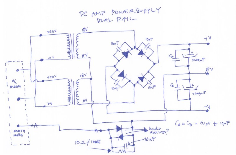

will this design work?

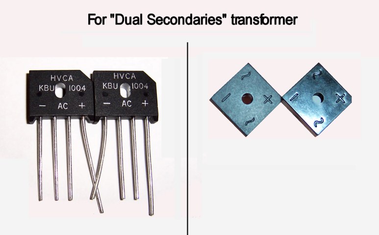

Since that's a dual secondaries transformer, why don't you use dual rectifiers? See photo.

Oh yes, here's a dual rectifier photo.

Depends what you mean by work. It will give -/+25 volts DC. Is that what you want ? You need diodes with a high surge current rating for big caps like those and with at least a 100 volt P.I.V. rating.

Make sure the phasing of the transformers is correct otherwise it will just be a paralleled half wave rectifier. ie. the ripple frequency will be the mains frequency rather than double the mains frequency.
You have taken one step towards improving the basic PS design. The 10nF across the diodes cuts out most of the switching noise. The next step is adding some film caps across the main reservoir caps, anything from 0.1uF to 10uF is typical. There are many more steps beyond...
Yes, my target was to get +/- 25volts powering up my split supply amp. But is there any difference between single supply and split supply amp?

ok, now this bridge diode, i believe any 5amp rating bridge should suffice, would it? as for the filter caps, usually 2200uF 50v would be ok.

+-25V and 2200uF smoothing does not sound right for an 8ohm speaker.
The peak current into a resistive load is [Vpsu-Vloss]/Rload~=[25-4]/8=2.6amps peak.
Into a reactive speaker load the peak current can be two to three times this value i.e. approaching 7Apk.
The ripple on 2200uF will be enormous.

Indeed. 4700 uF at least in a stereo application. I would have chosen 35 V rating of the caps.AndrewT said:+-25V and 2200uF smoothing does not sound right for an 8ohm speaker.
thanks Andrew, from other design I saw a 10,000uF cap with 0,1uF snub. This is the part that I missed, the Theory. So, how do we decide on what value should I use?

casiomax said:as suggested, i've revised the schematics:
Hey, I had suggested the 2200uF as helpers for the 10,000uF. That's sort of like Carlos's 2004 design. Smaller faster caps right at the rectifier, and. . . then. . . the 10,000uF. 😉
Also, whatever caps are right at the rectifier, they just get bombed, and you probably don't want to do that to just one pair of caps. So, that's why I suggested the addition of the 2200uF. Let those tackle the rectifier noises. . . thus keeping the 10,000uF clean and cool.

That wasn't instead of the 10,000uF. That was in addition to the 10,000uF. Total is 12200uF per rail.
casiomax said:. . . should we paralel 10,000uF with 2200uF ?
Yes.
See the carlosfm snubber power supply from 2004.
It has:

3300uF, (gets hit with rectifier noise)
10,000uF, (protected and stays clean)
snubber,
output terminals.
And is has these in that order.
Rectifiers make noise. That gets into the nearest capacitor. In the case of the carlosfm 2004 design, his 3300uF gets "hit" with the rectifier noise and some heat, while the 10,000uF stays clean.
