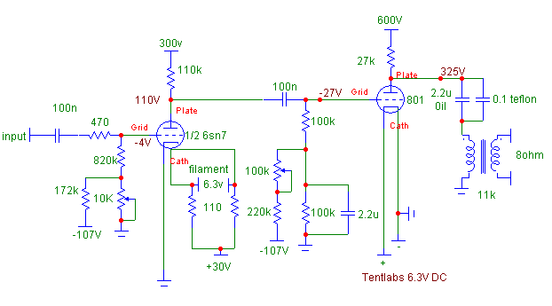

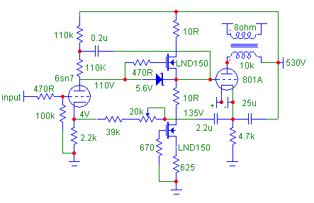

Darius,
You got me interested in this Loftin-White stuff, so I looked a little on the web. I find lots of schematics called Loftin-White, but none that have the output current loop as shown in the original design, or in your version. But you knew that I guess. Everyone seems to have focussed on direct coupling, but ignored the really cool part of the design - at least to my poorly trained eyes. Surprisingly, even John Broskie of TubeCad has got it wrong.
If I get to this down the road on my 801 amp, I may use a mosfet follower in place of the second triode (no room to add another, the FET's are smaller).
Sheldon
One thread I came across when searching the term Loftin-White, is this one: http://www.vintage-radio.net/forum/showthread.php?t=20849
Now, it's clear that the one poster did not understand the difference between feedback and what is going on in this circuit. I must confess that I was confused too. Pretty interesting how that happens. I think I'm beginning to see the difference now. Feedback implies that the input signal is compared with the output and the output corrected, based on the difference. I see now that the signal is not compared to the output.
In the Loftin-White, we are looking only keeping the power supply constant. The error signal that is compensated is only this one and has nothing to do with the input signal, except as it cancels ripple in the supply, whether caused by output demands or by residual supply ripple. You are right, it's pretty darn clever.
Here's an amp I intend to convert at some point:
