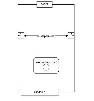

I have very unusual loudspeakers which I have built some time ago with those room-speaker interface things in mind. These are very short omnidirectional loudspeakers. They are just 20 cm high and have 8 inches wide range driver on top and firing upwards.
The loudspeakers are to work on the floor – the driver is only 20 cm above the floor – and against the wall.
In this positioning they happen to be quite similar to the late Stig Carlsson designs (carlssonplanet.com, but the Carlssons are two-way and much more complicated because of that) but were not inspired by them.
I didn’t know the Carlssons when I was building these and my first and main aim was to eliminate the detrimental effect of early floor and ceiling reflections without resorting to unavailable true linesource (like Beveridge)
The second aim was to build loudspeaker least visually obtrusive, loudspeaker that would be practically invisible in the listening room (which in may case at the time was also a living room). Perhaps it was even equally important goal.
But frankly speaking I wasn’t thinking a lot and I think now that I really didn’t know what I was doing and still I don’t – I have no technical background – and it was and it is all mostly intuitive.
But the outcome appeared to be quite satisfying. This is still work in progress. Achilles heel of the loudspeakers are 8 inches Fostex wide range drivers which have major resonant problems in the break-up area. Out of the box they were literally howling at me. After some driver-mutilating (i.e. tweaking) I can say that these problems are only partially solved for the time being and I am looking for a different driver
Soon I will have a new listening room that is 350 cm wide and 550 cm long. Not too big and not the best proportions but I can arrange it specifically for audio purposes.
I am considering positioning the speakers against the opposite longer walls (scheme attached). Stereo basis would be 330 cm. The listener is to be located 200 cm from stereo basis, 250 cm from both speakers
All this with the questions of minimizing early reflections in mind and particularly with what Dr. Geddes has written on this forum.
A big thanks goes to Dr Geddes!
To my not very big surprise the resulting set up happens to be very much like Beveridge positioning of his line source electrostatics.

hm said:
Hello,
do you make any measurements to compair it?
unfortunately I am not able to make any measurements
I am not a technical person
just a music lover
although I did simple calculations of reflections showing much better (than typical) reflection delay pattern
it is all discussed in the other thread
in case of Your speakers an absorber on the adjacent wall can be required because of their particularly low directivity, Fostex drivers we use are progressively beaming in the high frequencies of course
and also the problem of the ceiling reflection will not be eliminated (I am not sure what is vertical directivity of Your speakers)
hm said:
my experience with DDD driver and the
TROMBONE .. has shown min. distance to a wall ~65 cm.
yes, I am not surprised and I perfectly understand that
this requirement of min. 65 cm distance in case of Your speakers is supported by the same theory that supports positioning right next to opposite walls in my proposal
but, well, instead of discussing theories and measurements why not just give it a try? 🙂
the proof of the pudding is in the eating 🙂
happy experimenting!
best,
graaf

to save everyone interested in the setup reading through the lengthy original thread let me quote Etienne88 describing his listening impressions:
2) the bass output is much stronger. This is due to the fact that the LS is much closer to 2 surfaces: the floor and the side wall. Nevertheless I can now locate where the bass is coming from what I couldn't do before. It is not pin point localisation but still!
3) I am not sure if the room disappeared but I can say that there is a feeling of space that I did not have before. For example, with a recording made in a church, the church has become much bigger than before.
4) I will tend to say that I have a more 3D feeling but I lost some depth, that for sure! the 3D feeling might come from the LS positioning but as well from the fact that I don't see the drivers any more (they are hidden from my view by two couches that are facing each other along the side walls).
5) this one seems a bit contradictory to me and it is kind of hard to explain: I have deeper silences between the notes but it doesn't sound as clear as with the drivers facing me. The "deeper silences" thing comes from the fact that I can now hear some noises from the CD player while listening to music! About the clear sound: I have the feeling that I am much far away from the musicians than before. This is maybe linked to the lake of treble I feel with this set up...
6) The sweet spot has grown for a tiny little spot to an area!
What I really like with this set up is the fact that the sound is there, just there, not thrown in your face
I put my speakers back in the front firing position some days ago. After about 3 songs, I moved them back lying along the walls. It really surprised me!

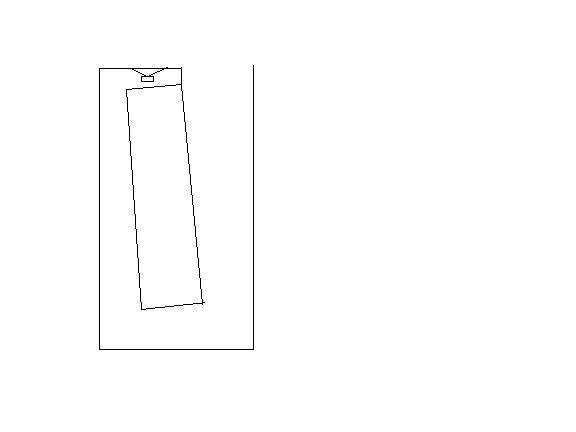

Hello hm!
I am not interested in listening to such a beamy driver on axis. The top driver (without front horn) would have to be the main driver. Do you think a tapped horn can work for a fullrange driver?

Hello el´Ol,
i don´t think so,
look my TUBA and ALPHORN, near a tapped.
The TUBA works because ~ 7 L press chamber and soft fibre
reduced the peaks over 100 Hz, most BLH gets to loud at 150 Hz.
a matter of size, length and mouth.
the ALPHORN has only a little press chamber, so the peak is louder, that why it is useful for only 2 Oktaves. Because the ALPHORN is so little it is useful to end the mouth not abrupt into the room, look the last 75 cm of the ALPHORN!!

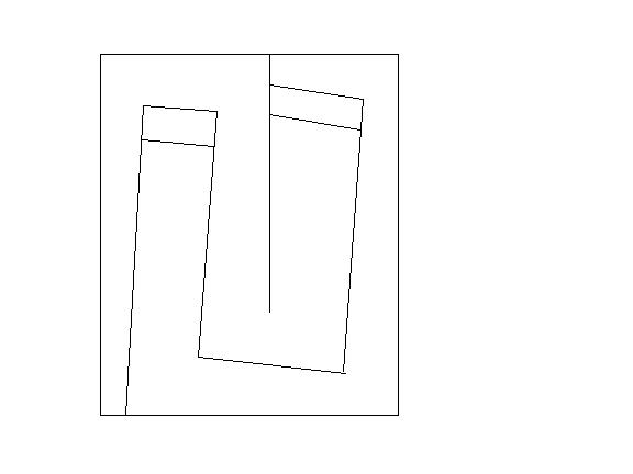

Hello hm!
The ratio in "Failure No. 1" is 4/3, in contrast to 3/2, as you propose. That the shorter horn opens slower should be good, as your observation is that the shorter horn goes lower. Maybe I should try.
About the tapped horn:
If I understand it right, you claim that the horns in your double horn concept interact outside the box, and there is also a Decware project that indicates that the air doesn´t necessarily have to be squeezed in somewhere:
http://www.decware.com/paper93.htm
So I guess I will also try this (picture), even if the chances to get something reasonable are low. Construction is simple and looks far less monolithic due to the rectangular cut-out.
